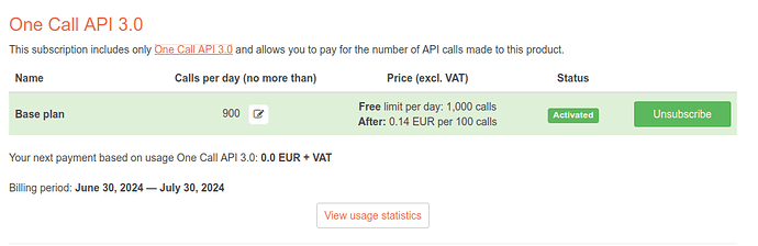

Open Weather Map (OWM) API 2.5 closing, switch to 3.0 API
Log into OWM. If, under “Services” it doesn’t say “One Call API 3.0” and next to “Basic plan” it doesn’t say “Activated” you are not using the 3.0 API and what ever is possibly working now will stop working when the 2.5 API is shut down.
There is no way around it. If you want to continue to use OWM, you must subscribe to the 3.0 API and to do that you must enter your payment information, even for the free plan.

@maDDin1338 I really recommend to just subscribe to One Call version 3.0, just set the daily API call limit to 1000 and you’ll never have to pay anything. And if you are still on openHAB 2.x, please consider migrating to 4.x — it is worth the effort.

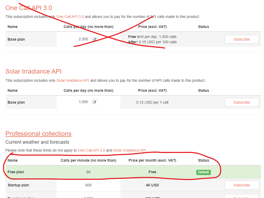

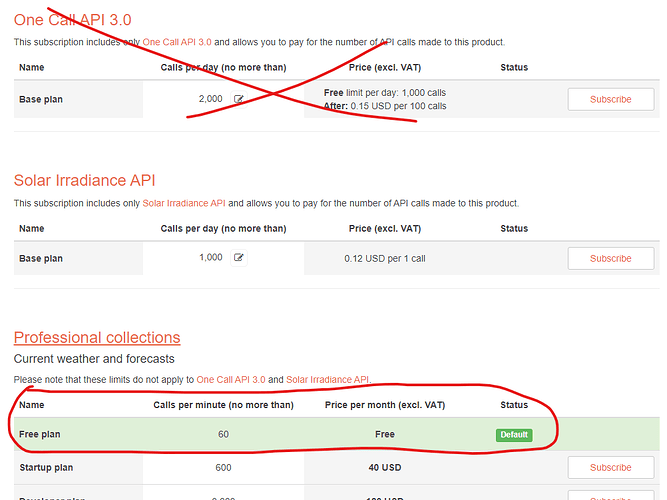

you absolutely do not need to subscribe to OneCall API. Simply use the free tier of professional
see this thread.
https://community.openhab.org/t/oh3-install-set-up-openweathermap-via-ui/114106
