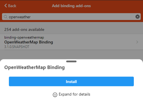

  2. Install OpenWeatherMap Binding
    Settings → Bindings → + (Add) Button in the lower right corner → Search for OpenWeatherMap and Install the binding.

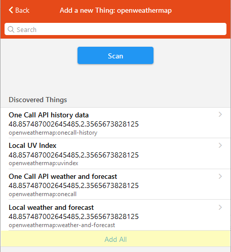

  4. Add more things
    Settings → Things → + (Add) → Select OpenWeatherMap Binding → Click Add All in the Discovered Things or just select the Things that you need.
    :red_exclamation_mark: Info: You need at least the Local weather and forecast and the One Call API weather and forecast thing to use the full functionality of the above mentioned weather widgets.
    004-add_things

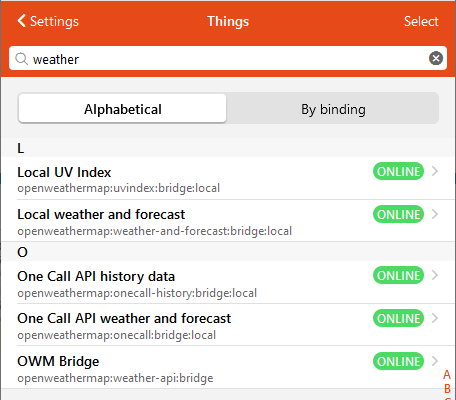

    Now all your Things should be visible in the Things overview and marked as Online

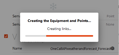

    Change the tab at the top to Channels → Scroll down to the bottom of the page → Click Add Points to Model
    008-add_points
    Now you can pick a Location or Equipment group within the semantic model where your items will be inserted (if you have one already) - click Pick from Model for this.
    If you don’t have a semantic model yet, you can leave this empty (what we will do here for demo purposes)
    If you would choose Expert Mode here, you’d get a text view with all of the channels that will be linked to the point items (including a suggested naming)
    009-link_channels

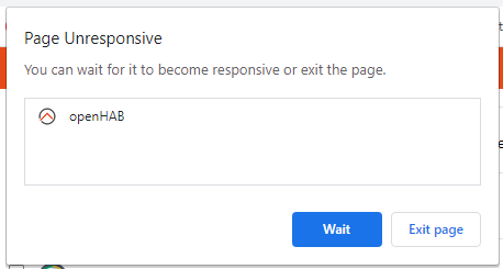

    As you might recognize at this point, the OneCall API Thing of the OWM binding has a lot of channels (666 :japanese_ogre: in the 7-days and 25-hour configuration)
    Linking all of them might cause your browser to get unresponisve multiple times within the linking process.
    If you just want to use the minimal required channels for the above mentioned weather-widgets, it would be enough to add ‘only’ 172 of the available channels…

Thanks for your detailed howto @RGroll,
With the 7 days & 25h setting you screenshotted above this added 666 items to my config :slight_smile: Whoop, whoop!
My Chrome alerted like 3 times about unresponsiveness until the the “Select all” finished up.
I guess these are a “few” items too much. Do you have a recommendation on the day & hour settings. I just want to add your awesome Weather widget from the other thread.
