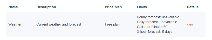

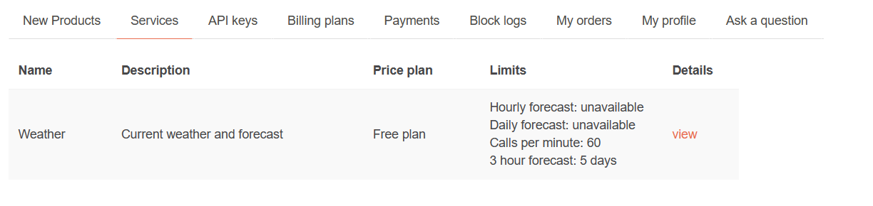

As you can see, I’m using the Free plan, so retrieving tomorrow’s data should be fine:

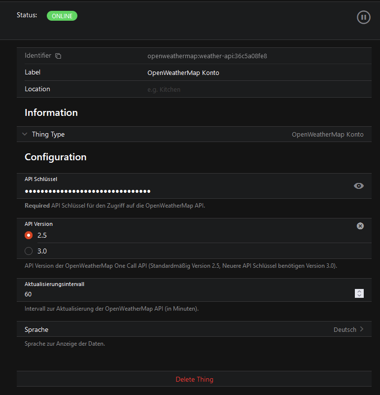

My OpenWeather account settings seem to be okay:

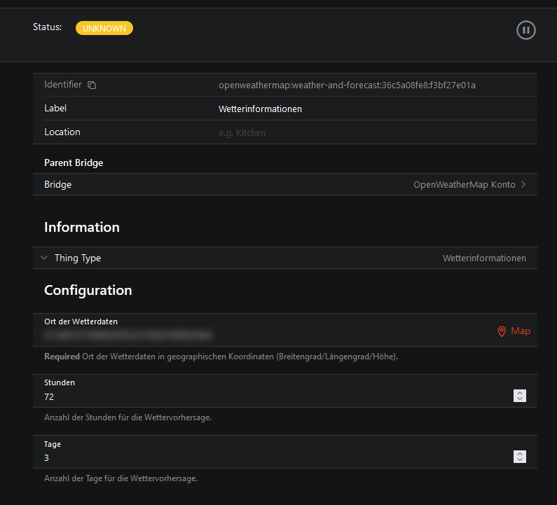

But when trying to load the forecast, the associated thing just remains Unknown:

The only log statements related to this thing are:
16:42:20.068 [INFO ] [hab.event.ThingStatusInfoChangedEvent] - Thing 'openweathermap:weather-and-forecast:36c5a08fe8:local' changed from UNINITIALIZED to INITIALIZING
16:42:20.088 [INFO ] [hab.event.ThingStatusInfoChangedEvent] - Thing 'openweathermap:weather-and-forecast:36c5a08fe8:local' changed from INITIALIZING to UNKNOWN
When creating a new thing from scratch, the default values are 24 hours / 0 days - using these values, the newly created thing switches to ONLINE immediately.

Thats what my openweathermap.org profile is showing:
It looks exactly the same in my profile :face_with_crossed_out_eyes: do we maybe have a different understanding of One Call API?
According to this page , it is pay as you go with 1000 requests per day for free. However, when subscribing to this API, I’m forced to enter my credit card data.
Instead, the two of us are currently using the Free plan from what I understand, but I might be wrong.
Anyhow… could you please post a screenshot of your a) your OpenWeather bridge/account settings and b) your current OpenWeather condition settings within openHAB as I did in my original post? I just want to try it with your settings…
