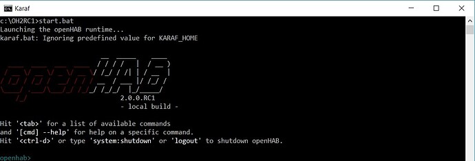

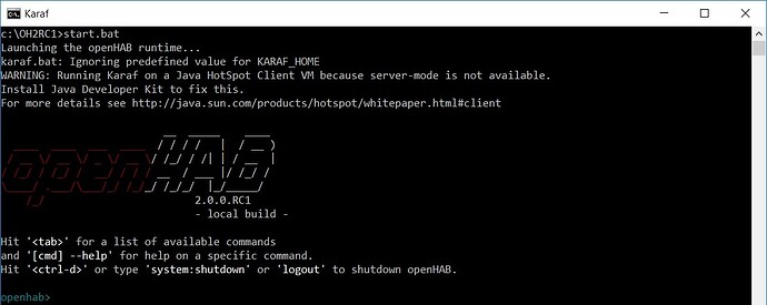

With Oracle JRE and the JAVA_HOME environment variable set to C:\Program Files (x86)\Java\jre1.8.0_121, the startup on Win 10 x64 will look like:

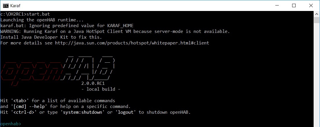

With Oracle JDK and the JAVA_HOME environment variable set to C:\Program Files\Java\jdk1.8.0_121, the startup on Win 10 x64 will look like:
(you won’t get that annoying Karaf warning :slight_smile: )
