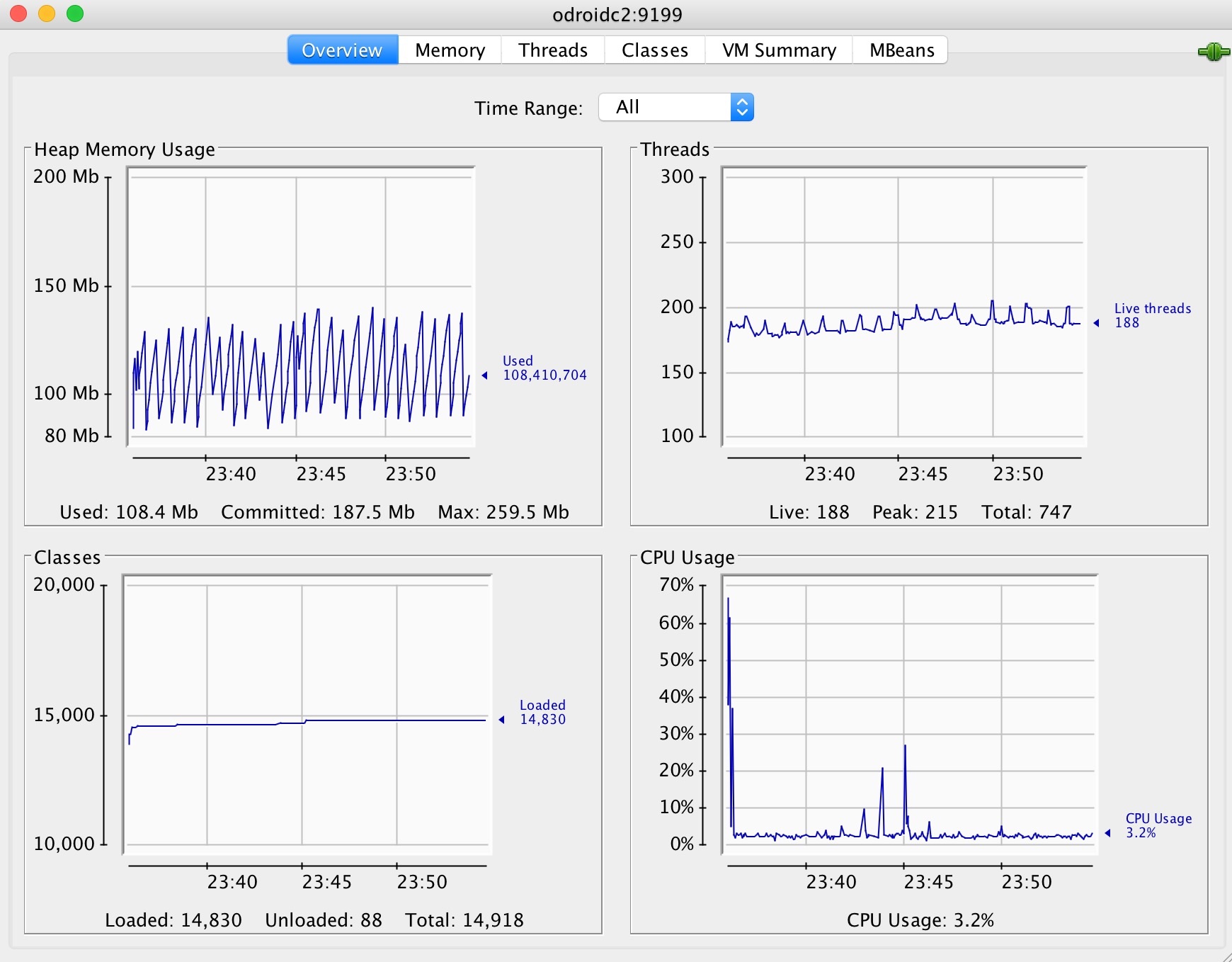

I use an ODROID-C2 arm64 device to run openHAB. Up until version 2.0 of openHAB, this worked fine. Was running 64 bit JVM without any problem. But when I upgraded to version 2.1 the server starts to use a lot of cpu and always ends up maxing out on cpu.
On this forum I read that 32 bit JVM is probably better on arm platform. So I installed Oracle 1.8.0_144-b01 JDK. But this also maxes out after a while (couple of hours).
I tried to find out what is causing this high cpu usage. But I was not successful until now. I tried to switch of bundles one by one, but the cpu didn’t decrease.
Does anyone have any clues? The heap size doesn’t look that big (256 Mb), but I think this is managed by Karaf.
I don’t think many other users are experiencing the same problem. So I think it must be related to the device I’m using. Need to investigate some more. Maybe look into the Garbage Collection process?
After downgrading to openHAB 2.0 the cpu usage is normal again.
Sounds pretty weird. Does the “Threads” tab give you any clue? You should try to figure out, which thread is taking all the CPU and what this is doing.
Weird indeed. I’ve been looking through the treads, but didn’t find one that stands out. I’m not an expert on this kind of troubleshooting, so I need to find out most of the stuff on Google. But there is a lot off information on the internet. Unfortunately no situation/case is the same so it will take some time.
