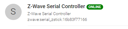

With Z-Wave, when you add your controller, give it the same ID as your old one. That should make the thingids for the device match your old one since the network association is stored on the controller, not in OpenHAB. Your Item channel links would then be the same & can be copied from your old configuration.
