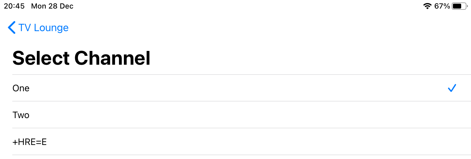

So channels, I have their names
And the nance translate to a number, 1,2,3 etc. this is done in the sitemap
Group item=g_rm3_lounge_samsung label="TV Lounge" {
Switch item=rm3_lounge_samsung_power
Switch item=rm3_lounge_samsung_volume
Switch item=rm3_lounge_samsung_mute
Switch item=rm3_lounge_samsung_channel
Selection item=rm3_lounge_samsung_source mappings=[hdmi1="Apple TV",hdmi2=PC,hdmi3=Playstation,hdmi4=Chromecast,tv=TV]
Selection item=rm3_lounge_samsung_channel_select mappings=[1="One",2=Two,3="+HRE=E",4="Bravo",5="Maori",6="One+1",7="Two+2",8="+HRE=E+1",9="Bravo+1",10="Prime",11="The Edge",12="Choice",13="Duke"]
} //Group item=g_rm3_lounge_samsung label="TV Lounge"
This will be tricky with the current method of topics and commands (replay
) that you’re using. However, based on this presumably you’re using the broadlink-mqtt
project? (I’m not a stalker, honest - just recognise the username!)
If so, then instead of :
TOPIC: broadlink/34ea34b2f9c5/tv/samsung/numtwo
MESSAGE: replay
You can do:
MESSAGE: numtwo
This makes your configuration much simpler. I don’t know how your Bridge Thing is set up - I’ll assume you have everything in the same file. You can then have the following device Thing:
Thing
Thing topic TVSamsung "Samsung TV" {
Channels:
Type string : swChannel "TV Channel" [
commandTopic="broadlink/34ea34b2f9c5/tv/samsung"
Item
String rm3_lounge_samsung_channel_select "TV Channel" {channel="mqtt:topic:TVSamsung:swChannel"}
Sitemap
Selection item=rm3_lounge_samsung_channel_select label="Channel []" mappings=[numone="One",numtwo="Two",numthree="+HRE=E",numfour="Bravo",numfive="Maori",numsix="One+1",numseven="Two+2",numeight="+HRE=E+1",numnine="Bravo+1",numten="Prime",numeleven="The Edge",numtwelve="Choice",numthirteen="Duke"]
