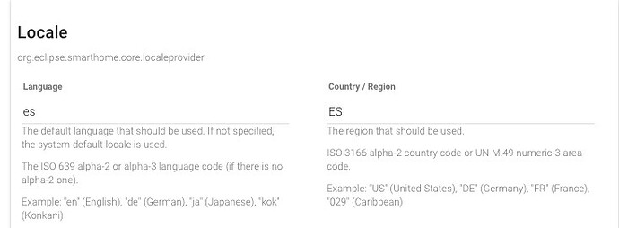

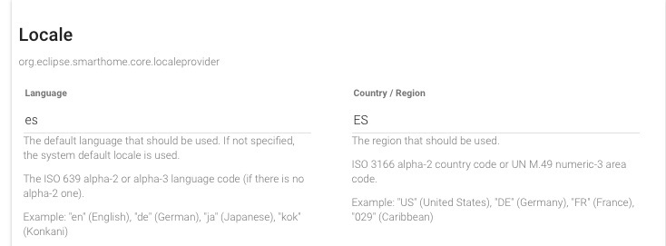

Regarding the default language here is how it acts in my case.
Every time I do a say command, it renders it in a different language.
Yes, see https://github.com/openhab/openhab2-addons/issues/1418. Only appears if you use VoiceRSS.
