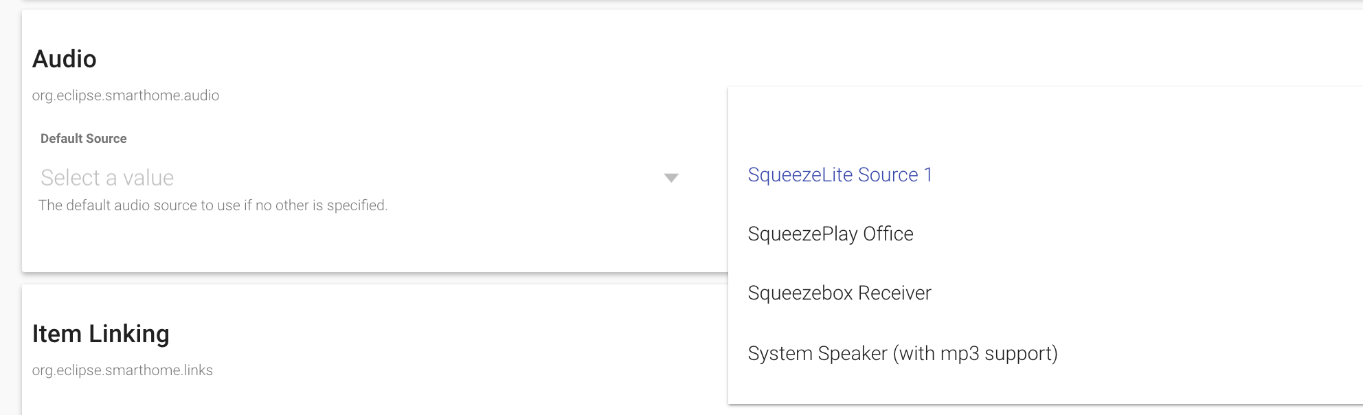

and how could i set it as default sink? there’s no option for any squeezebox player under ā€œconf / system / audioā€ to select…

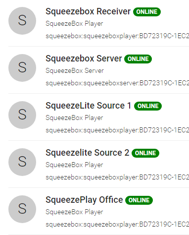

The Squeeze player(s) should show up in the dropdown list for Audio Sink. Like this.
Are you certain you’re on a version of OH2 that includes the Squeezebox binding that has Audio Sink support? Audio Sink support was added back in February of this year.

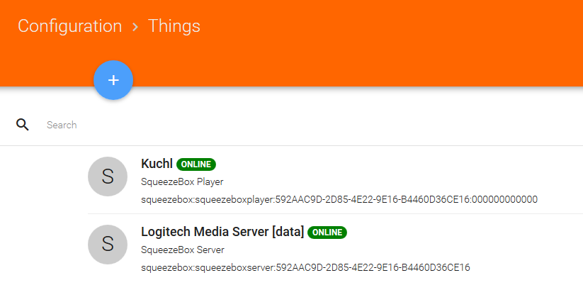

no, neither is my pCP listed on thinks like it’s on your screenshot.
Ok, so can you confirm that in Paper UI under Configuration->Things you have a Logitech Media Server and a Squeezebox Player, similar to this image?
Note that the default name of Logitech Media Server is something like Logitech Media Server. Mine is called Squeezebox Server simply because I want it to sort so that it’s with the players.
yes!
