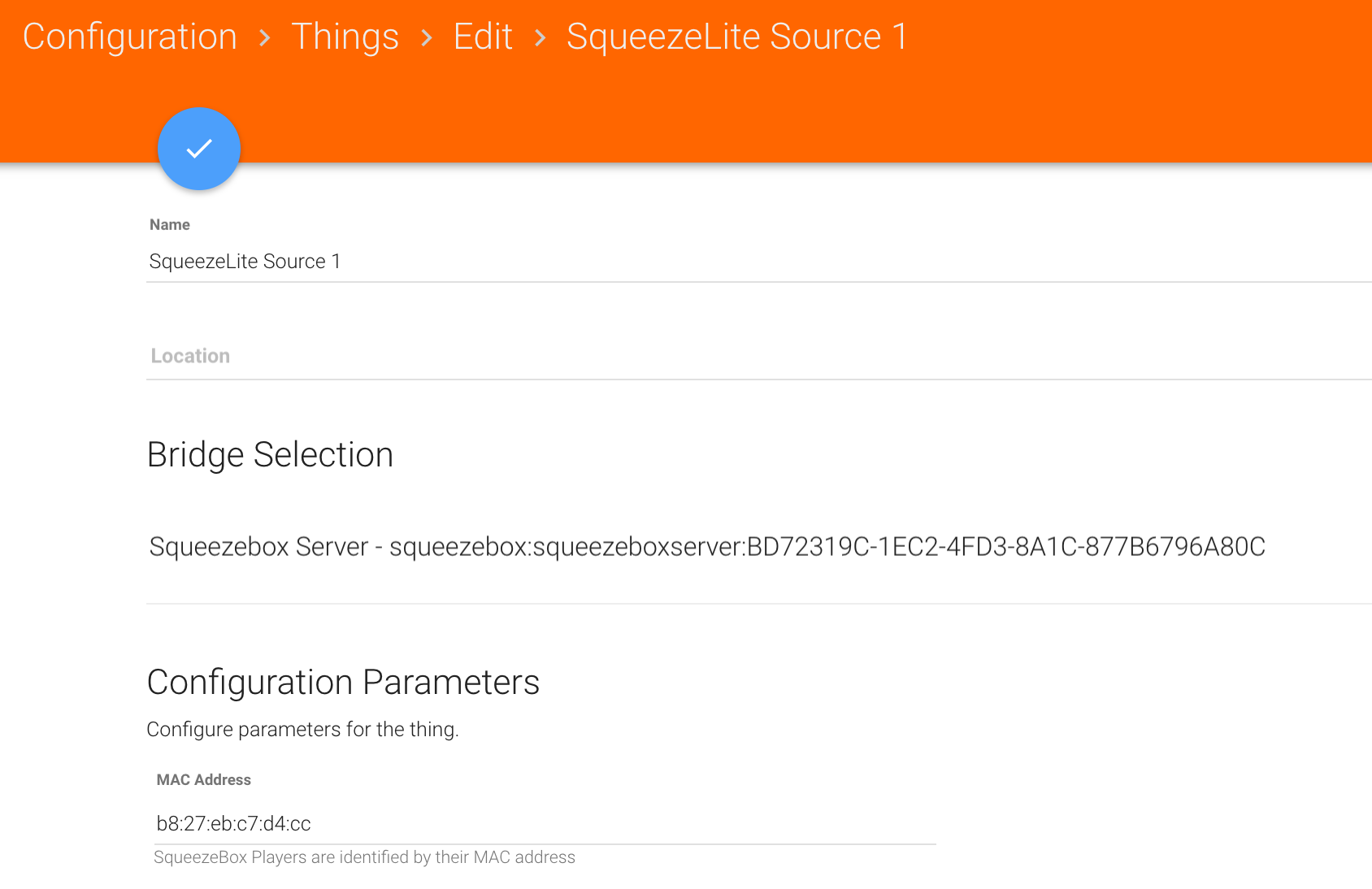

I think it means that the player thing is not associated with a Squeezebox server.
In Paper UI, go to the Configuration page for your player. There’s a configuration parameter called Bridge Selection. That parameter should be the Thing UID of the Logitech Media Server.
Like this.
perfect! my eternal gratitude goes to you, my friend!
You’re most welcome. Glad we got it working.
