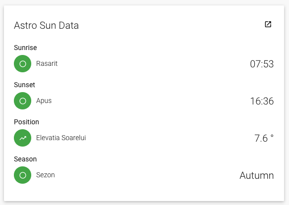

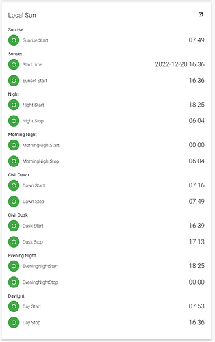

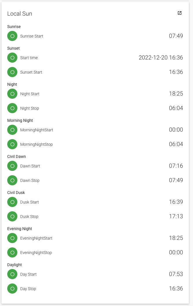

Related Things are green in PaperUI but information is wrong and stuck.
Can you clarify - they look reasonable to me (not knowing your location), I can see today’s date, and Astro generated values will normally remain the same from one midnight to the next.

Hmm, After some reboots it started to work, except the season part. It is still autumn from his side.
I guess you are on Earth but we do not even know what hemisphere you are in yet. You have to offer info if you want sensible help. What are you looking at that says autumn?
Hey, sorry. It should definetly say winter instead of autumn. I’m in Romania.
I have some rules that are triggered also by the season.
I see the season name in a sitemap entry,
  Text item=SeasonName icon="sun_clouds"
That doesn’t tell us how that Item gets populated, at all.
And in Paper UI.

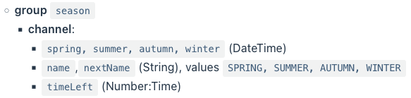

should grab seasib info from from this channel.
Most probably it does .. It will do…
According to Winter Solstice – When Is Winter 2025 and 2026?
In Bucharest, Romania winter starts : Wednesday, 21 December 2022, 23:48 EET
This corresponds to Wednesday, 21 December 2022, 21:48 UTC.
It is not just the date also the time is required …
