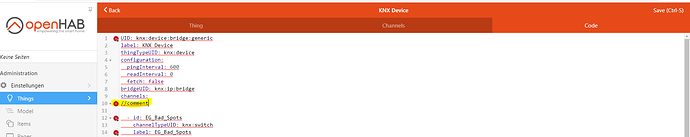

Or is it maybe better to use the “Code section” on the Openhab-UI ? → Is there also a way to add comments?

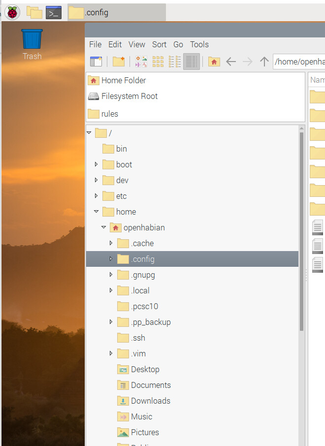

I’ve seen the file structure in OH3 is completely different.
→ Can someone send me a path to the things or rules folder?

Your config folder should be located under /etc/openhab/ on your PI.
Run ls -l /etc/openhab/ and check which user the folder owner or post the output here.
If it is different from openhabian you may face permission problems like i did.
(openhabian is the user that generates the samba shares, so it has to be owner of this files so you can edit them.)
