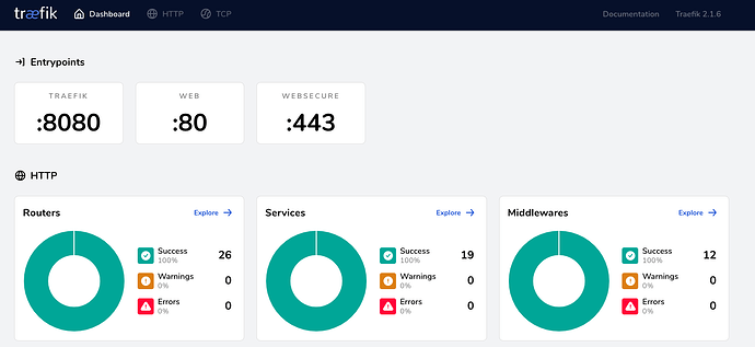

Traefik does that with letsencrypt of course ![]()
19 services, running on the same public IP, the same port, just with different host names and URLs, and a wildcard DNS record.
7 services, running on the same public IP, the same port, just different host names and URLs, and a wild card DNS record using HAProxy on pfSense. Traefik is a great product but it’s not like it’s the only one that can do that. Any reverse proxy can. But we are getting off topic for this thread.
Yeah of course it’s not the only one. The cool thing with it is that it’s mostly dynamic - associated with containers - nothing to configure manually by hand
But true - off topic

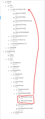

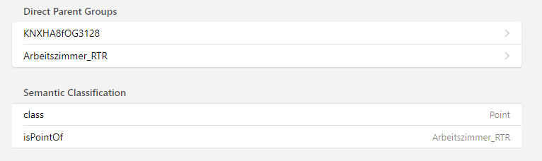

I’m trying to rebuild my home in OH3 and to understand the new concept of Equipment.
In the semantic model one equipment is displayed only once - even if it’s assigned to different groups.
Is this only unfinished or do I misunderstand the concept?
For example:
A physical device Thing is a “KNX 4 channel heating actor” with ~15 channels that are belonging to 4 different rooms (actor)
A virtual device Equipment is the “Room Temperature Controller” in a single room (controller)
The point “current temperature” from a zwave-device and the point “current heating state” from the actor should be available in both places in the Semantic Model - but there were only displayed once:
