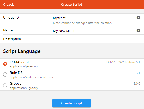

Scripts
You can now use the UI to write “scripts”, which are rules that don’t have any triggers or conditions but a simple script action to execute your own code. When you create a script you’re just asked for an ID, label, description, and the language you prefer:
openHAB has support for ECMAScript (aka. JavaScript) and its Rule DSL by default but you can now add more languages by installing automation add-ons - a new add-on category; Groovy is the first language you can install but I’m sure there will be more.
Since Scripts are actually Rules, you can trigger them from other (UI-based) rules with the ‘Run Rules’ action. You can also run them on-demand, either while editing them, or with the ‘run rules’ action in widgets that support it.

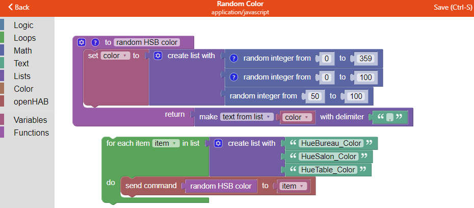

Blockly
openHAB 3.0.0.M2 has experimental support for Blockly as an alternative way to write your JavaScript script conditions and actions in rules (and now standalone “Scripts”) that you edit via the UI.
There are a number of limitations:
  • Blockly is only available in Script rules, actions and conditions when you select ECMAScript as your language of choice;
  • when you start writing your own JS code, you cannot switch to Blockly - you have to start from scratch to build your rule with Blockly. Just erase the code and you will see the button appearing again;
  • when you start designing a rule with Blockly, you can have a preview of the JavaScript code that will be generated, but you cannot edit it - the only way you can go back to writing your own code is to delete everything in the Blockly view and switch back to the Code view (with Ctrl-B or the button on the lower-right corner).

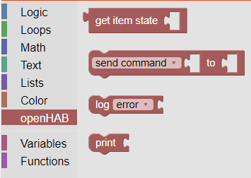

There are only a few blocks in the openHAB category currently to interact with your system, so it’s quite limited - but in many cases reading and writing items will be enough at least for now!
It’s bound to be expanded, but there are only so many hours in a day. I can imagine being able to call thing actions or making HTTP requests, and more, and there is much to do in that area - if you’re willing to contribute new blocks, and can understand a little JavaScript, please step up, contributors especially in that area would be appreciated! I’ll be glad to assist you in how to write them.

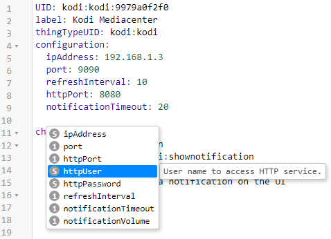

Autocompletion Everywhere
Many of the Code views you see throughout the UI now have “smart” autocompletion to help you write your code - whether it’s Things (a new way of configuring them in the UI), rules, pages or widgets, you can hit Ctrl-Space on your keyboard and chances are, you will get some hints:
It’s not perfect, and there are still ongoing issues with it, but overall it works pretty well and will help you configure stuff way easier when you choose to edit a little bit of YAML instead of clicking through the UI - just hit Ctrl-Space when in doubt and you might get the insight you need.

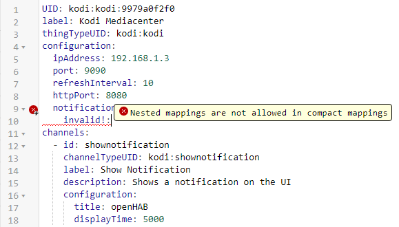

By the way - previously the errors in a YAML code editor would be displayed in an area below which would take a lot of screen real estate; now the errors are shown with wavy underlines and tooltips:

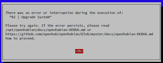

Error while upgrading
Rpi4 8g Running opehabian - openhabian-pi-raspios64beta
Yes this is untested beta software and no I don’t rely on it to be working. Someone has to test
installed openhab package post-installation script subprocess returned error exit status 1
apt-get upgrade --yes
Reading package lists... Done
Building dependency tree
Reading state information... Done
Calculating upgrade... Done
The following packages will be upgraded:
  openhab openhab-addons rpi-eeprom
3 upgraded, 0 newly installed, 0 to remove and 0 not upgraded.
Need to get 253 MB of archives.
After this operation, 12.1 MB of additional disk space will be used.
Get:1 https://openhab.jfrog.io/openhab/openhab-linuxpkg testing/main arm64 openhab all 3.0.0~M2-1 [82.0 MB]
Get:2 http://archive.raspberrypi.org/debian buster/main arm64 rpi-eeprom arm64 10.2-1 [386 kB]
Get:3 https://openhab.jfrog.io/openhab/openhab-linuxpkg testing/main arm64 openhab-addons all 3.0.0~M2-1 [170 MB]
Fetched 253 MB in 1min 53s (2,229 kB/s)
apt-listchanges: Reading changelogs...
(Reading database ... 52682 files and directories currently installed.)
Preparing to unpack .../openhab_3.0.0~M2-1_all.deb ...
Unpacking openhab (3.0.0~M2-1) over (3.0.0~M1-1) ...
Preparing to unpack .../openhab-addons_3.0.0~M2-1_all.deb ...
Unpacking openhab-addons (3.0.0~M2-1) over (3.0.0~M1-1) ...
Preparing to unpack .../rpi-eeprom_10.2-1_arm64.deb ...
Unpacking rpi-eeprom (10.2-1) over (10.1-1) ...
Setting up openhab (3.0.0~M2-1) ...
Installing new version of config file /etc/openhab/services/addons.cfg ...
Installing new version of config file /etc/openhab/services/runtime.cfg ...
[openHAB] Performing post-update tasks for version 3.0.0:
  Replacing: String org.eclipse.smarthome.i18n to org.openhab.i18n in file /var/lib/openhab/config/org/openhab/i18n.config
  Moving:   From /var/lib/openhab/config/org/eclipse/smarthome/audio.config to /var/lib/openhab/config/org/openhab/audio.config
  Replacing: String org.eclipse.smarthome.audio to org.openhab.audio in file /var/lib/openhab/config/org/openhab/audio.config
  Moving:   From /var/lib/openhab/config/org/eclipse/smarthome/voice.config to /var/lib/openhab/config/org/openhab/voice.config
  Replacing: String org.eclipse.smarthome.voice to org.openhab.voice in file /var/lib/openhab/config/org/openhab/voice.config
  Replacing: String org.eclipse.smarthome.folder to org.openhab.folder in file /var/lib/openhab/config/org/openhab/folder.config
  Replacing: String org.eclipse.smarthome.threadpool to org.openhab.threadpool in file /var/lib/openhab/config/org/openhab/threadpool.config
  Replacing: String org.eclipse.smarthome.autoupdate to org.openhab.autoupdate in file /var/lib/openhab/config/org/openhab/autoupdate.config
  Replacing: String org.eclipse.smarthome.lsp to org.openhab.lsp in file /var/lib/openhab/config/org/openhab/lsp.config
  Replacing: String org.eclipse.smarthome.rulehli to org.openhab.rulehli in file /var/lib/openhab/config/org/openhab/rulehli.config
  Replacing: String org.eclipse.smarthome.core to org.openhab.core in file /var/lib/openhab/jsondb/org.openhab.core.config.discovery.DiscoveryResult.json
  Replacing: String org.eclipse.smarthome to org.openhab.core in file /var/lib/openhab/jsondb/org.openhab.core.config.discovery.DiscoveryResult.json
  Replacing: String org.eclipse.smarthome.core to org.openhab.core in file /var/lib/openhab/jsondb/org.openhab.core.items.Item.json
  Replacing: String org.eclipse.smarthome to org.openhab.core in file /var/lib/openhab/jsondb/org.openhab.core.items.Item.json
  Replacing: String org.eclipse.smarthome.core to org.openhab.core in file /var/lib/openhab/jsondb/org.openhab.core.items.Metadata.json
  Replacing: String org.eclipse.smarthome to org.openhab.core in file /var/lib/openhab/jsondb/org.openhab.core.items.Metadata.json
  Replacing: String org.eclipse.smarthome.core to org.openhab.core in file /var/lib/openhab/jsondb/org.openhab.core.thing.link.ItemChannelLink.json
  Replacing: String org.eclipse.smarthome to org.openhab.core in file /var/lib/openhab/jsondb/org.openhab.core.thing.link.ItemChannelLink.json
  Replacing: String org.eclipse.smarthome.core to org.openhab.core in file /var/lib/openhab/jsondb/org.openhab.core.thing.Thing.json
  Replacing: String org.eclipse.smarthome to org.openhab.core in file /var/lib/openhab/jsondb/org.openhab.core.thing.Thing.json
  Deleting Directory: /var/lib/openhab/config/org/eclipse/smarthome
  Deleting Directory: /var/lib/openhab/config/com/eclipsesource
dpkg: error processing package openhab (--configure):
dpkg: dependency problems prevent configuration of openhab-addons:
 openhab-addons depends on openhab; however:
  Package openhab is not configured yet.
dpkg: error processing package openhab-addons (--configure):
 dependency problems - leaving unconfigured
Setting up rpi-eeprom (10.2-1) ...
Processing triggers for man-db (2.8.5-2) ...
Processing triggers for systemd (241-7~deb10u4) ...
Errors were encountered while processing:
 openhab
 openhab-addons
Updating FireMotD available updates count ...
E: Sub-process /usr/bin/dpkg returned an error code (1)
FAILED
Working now after
[01:24:56] openhabian@openHABianDevice:~$ sudo apt-get upgrade
0 upgraded, 0 newly installed, 0 to remove and 0 not upgraded.
2 not fully installed or removed.
After this operation, 0 B of additional disk space will be used.
Do you want to continue? [Y/n] y
[openHAB] openHAB was not running so will not start after upgrade.
[openHAB] Please use the command:
            sudo /bin/systemctl start openhab.service
Setting up openhab-addons (3.0.0~M2-1) ...

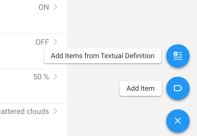

first of all, thank you for that awesome Milestone! It’s fantastic. I am playing around with the new version and have one question. Is it or will it be possible to import existing thing and item files?
Thank you for your work and help!
johannes
It’s already possible to import existing Item files.
After clicking the + icon on the Items page select “Add Items from Textual Definition” and you can paste the contents of a .items file there and it will load them into JSONDB. NOTE: You then will need to remove the .items file. You don’t want OH to have the same Item defined in both places.
There is no equivalent for .things files (yet?). But for that case you would probably want to rediscover the Things anyway.
Thank You, for items thats fantastic, but for my knx thing file it is a desaster… I have to manual add every knx device and the channels withe the adresses… Is there no other possibility for things than readding them by the UI?
You can keep on using the .things files you already have. Support for .things and .items files don’t go away.

One thing you could try is request http://oh2:8080/rest/things on your openHAB 2 instance. This will dump every thing in JSON format. It’s ugly but you can pretty-print it for instance with Best JSON Pretty Print Online, so you can identify individual things more easily - it’s an array of objects like
You have to extract every one of those objects, and in OH3 you can go to Developer Tools (on the left), API Explorer, expand “things” then the green “POST /things” entry. On the right click on Try it out, and paste the things you extracted from above under “thing data”, overwriting the example. Then click on the Execute button. This should add the thing to the internal DB.
I’m not guaranteeing this will work 100% but you can try with one thing and see how it goes.
If you know a scripting language like Python it wouldn’t even be too hard to write a program with a simple loop to do all this for you.
The .things syntax is a little more convoluted than the .items syntax (it’s also far less documented) so writing a Nearley grammar for it so to parse them into JS objects is even more of an headache. It’s also not a flat list, there are blocks and so on. For reference the grammar for the .items syntax is here: openhab-webui/bundles/org.openhab.ui/web/src/assets/items-lexer.nearley at main · openhab/openhab-webui · GitHub. There’s also one for sitemaps here: openhab-webui/bundles/org.openhab.ui/web/src/assets/sitemap-lexer.nearley at main · openhab/openhab-webui · GitHub
If anyone wants to give it a shot, though, that would be awesome :slight_smile:
