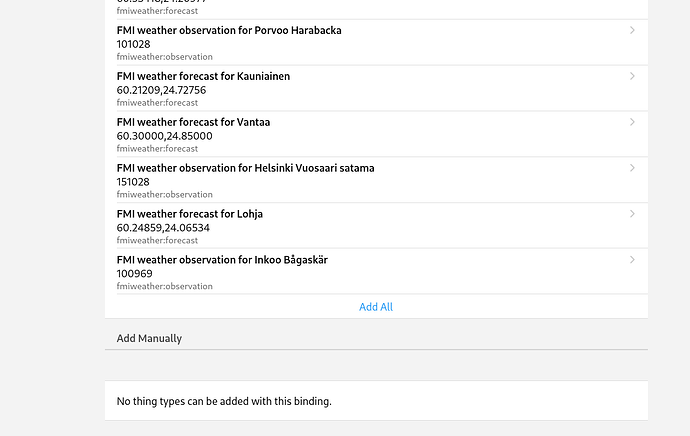

I’m having issues adding things from inbox. Is this a known issue?
Using FMI weather binding. When I try to add the thing, I get “Error during thing creation: Conflict” popup.
In the log I have:
20:55:15.789 [ERROR] [enhab.core.thing.binding.ThingFactory] - Thing factory (class org.openhab.binding.fmiweather.internal.HandlerFactory) returned null on create thing when it reports to support the thing type (fmiweather:forecast).
20:55:15.789 [WARN ] [ig.discovery.internal.PersistentInbox] - Cannot create thing. No binding found that supports creating a thing of type fmiweather:forecast.
Completely clean slate, with manual installation of addons & runtime
I had that problem a long time ago with just astro & zwave installed. The issue at that time was the zwave binding but it has since been fixed.
As a test try uninstalling other bindings.
Why manual installation? are you sure they are compatible with OH3?
Regarding manual installation: it was offered as one option so I assume it is supported or at least meant to be tested.
Ok could try having only that binding…
I would try only that binding. That is how I found the issue with zwave earlier.
I tried again, manual install, and installing only fmiweather, still the same error.
openhab> bundle:list -s|grep org.openhab.*
128 │ Active │  80 │ 3.0.0.M2                │ org.openhab.core
...snipped org.openhab.core.* ...
193 │ Active │  80 │ 3.0.0.M2                │ org.openhab.ui
216 │ Active │  80 │ 3.0.0.M2                │ org.openhab.binding.fmiweather
217 │ Active │  80 │ 3.0.0.M2                │ org.openhab.persistence.rrd4j
218 │ Active │  80 │ 3.0.0.M2                │ org.openhab.ui.basic
219 │ Active │  80 │ 3.0.0.M2                │ org.openhab.ui.habpanel
220 │ Active │  80 │ 3.0.0.M2                │ org.openhab.ui.iconset.classic
Discovery works as it should but cannot add the things.
23:56:11.518 [INFO ] [ig.discovery.internal.PersistentInbox] - Added new thing 'fmiweather:observation:station_100996_Helsinki_Harmaja' to inbox.
23:56:11.518 [INFO ] [smarthome.event.InboxAddedEvent      ] - Discovery Result with UID 'fmiweather:observation:station_100997_Kirkkonummi_Makiluoto' has been added.
23:56:11.518 [INFO ] [ig.discovery.internal.PersistentInbox] - Added new thing 'fmiweather:observation:station_100997_Kirkkonummi_Makiluoto' to inbox.
23:56:32.782 [ERROR] [enhab.core.thing.binding.ThingFactory] - Thing factory (class org.openhab.binding.fmiweather.internal.HandlerFactory) returned null on create thing when it reports to support the thing type (fmiweather:forecast).
23:56:32.782 [WARN ] [ig.discovery.internal.PersistentInbox] - Cannot create thing. No binding found that supports creating a thing of type fmiweather:forecast.
EDIT:
This does not look right:
“No thing types can be added with this binding”
To me this is conflicting with
Either it reports the thing it can create or it does not :slight_smile:
Has this been reported as a bug already? Do others have similar issues with other bindings?

@Kai Could you tell us a little bit about feature not implemented yet? I think everyone is keen to see the feature comming latest under the xmas tree.
I see no open issues for fmiweather. Please open one here.
This is a known issue that already has a PR with a fix.
Added now a bug for the buggy discovery [fmiweather] Cannot add discovered things from inbox in OH3 / cannot create things manually · Issue #8971 · openhab/openhab-addons · GitHub
The issue seems to be present only in OH3, not 2.5.10 so I’m not sure where to look for issues.
EDIT: already resolved by core maintainers (!!!), some deep issue: [fmiweather] Cannot add discovered things from inbox in OH3 / cannot create things manually · Issue #8971 · openhab/openhab-addons · GitHub
