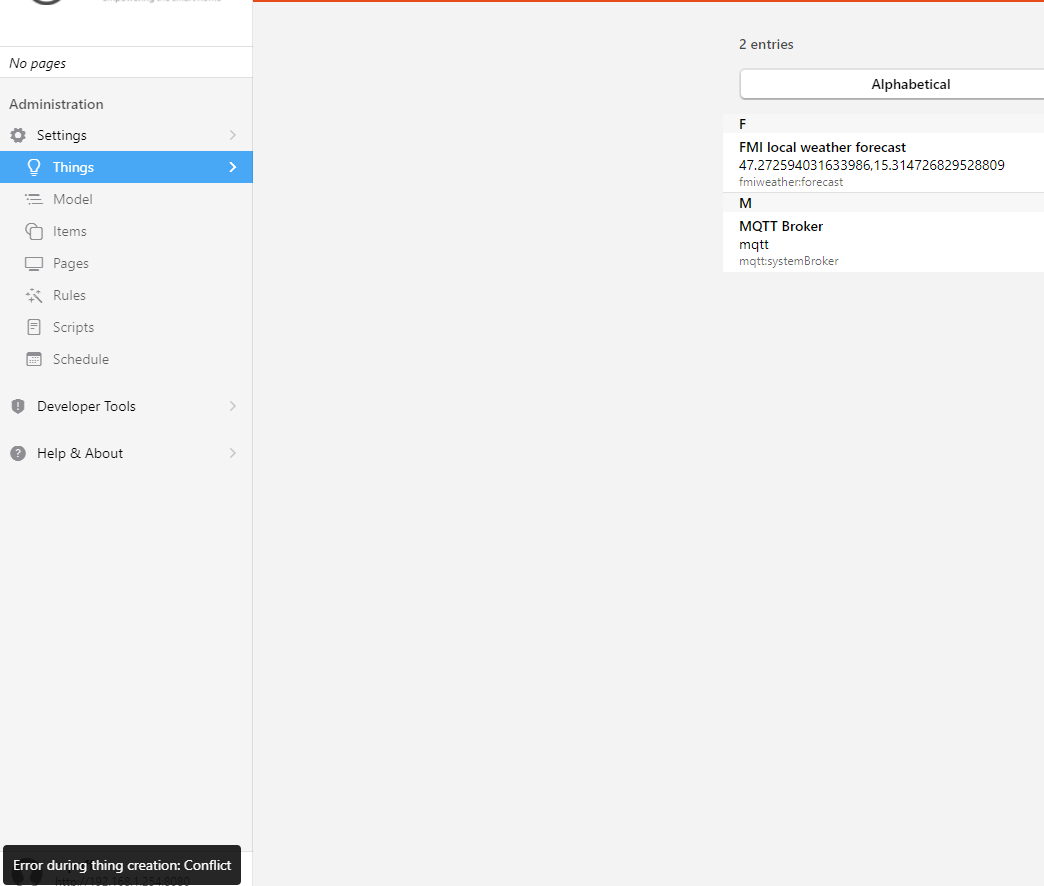

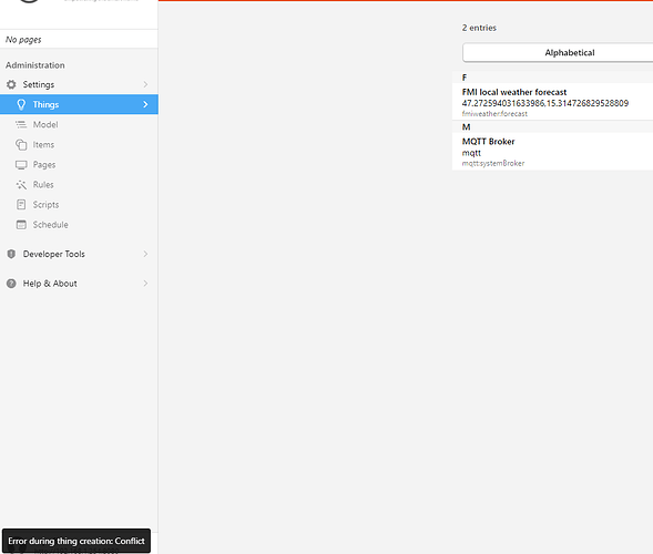

i cant add fmiweather as thing
i get this error:

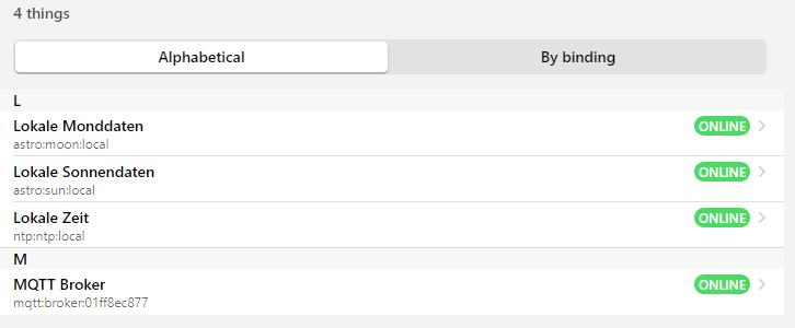

and i only have these items in my oh3 installation:
You’re probably trying to add another Thing with the UID fmiweather:forecast when one with that UID apparently already exists, that’s why you get a HTTP 409 Conflict error.
