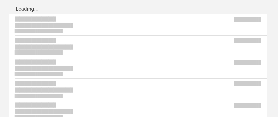

The only thing that does not work: I can’t open the rules page in the UI.
It just hangs while loading:
I can’t see anything in the logs nor is there anything in the browser console.
I’ve tried with Chrome (including incognito mode), Edge, Firefox and even IE11, at no avail.
Cleared the cache: no change.
rules GET in the API Explore returns the complete list of rules, so they are there. They actually even wor but unfortunately I cannot edit them.
I’m at the end of my wits.
Has anybody else seen such issues or does anybody have an idea what may have gone wrong?
