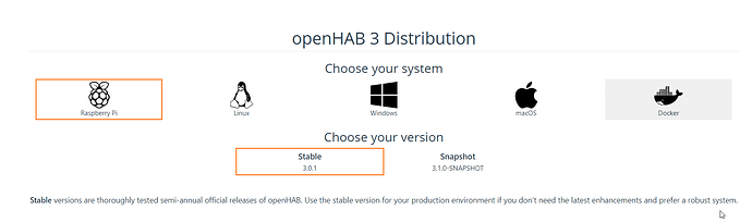

I saw, that 3.0.1 is available on downloadpage:

Thank’s for the release notes.
Is it ok to update, or should the 3.0.1 core package also be available with apt upgrade?

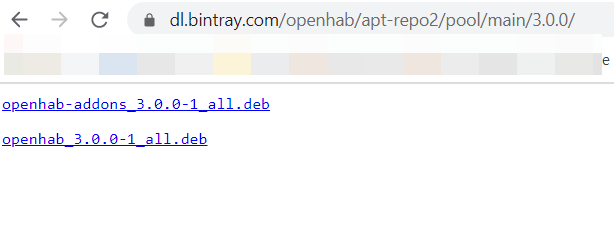

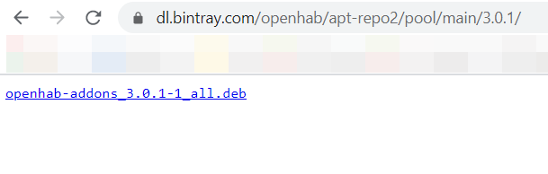

It look’s like the 3.0.1 core package is missing in the repo:
For 3.0.0 it look’s like this:
I assume something went wrong, when syncing the repo?
The 3.0.1 build didn’t go well, therefore it wasn’t announced yet either. I have wiped it from the binary repos and a new build is underway - hopefully it’ll be available by tonight.
