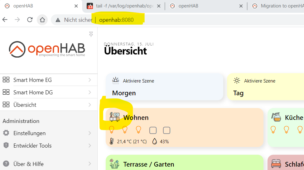

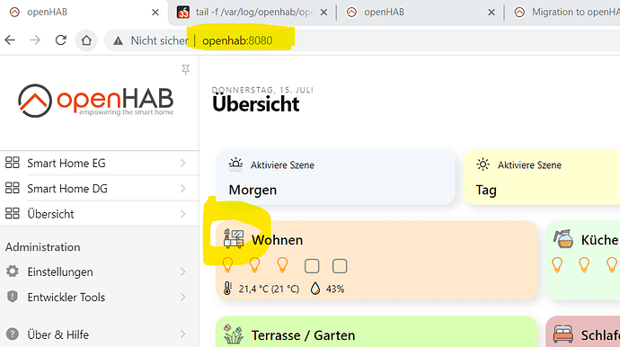

When I open the overview page (default start page without “/page/…” in the URL) the icons are displayed even after I do a refresh (I first thought that they show up because they are stored in the cache).

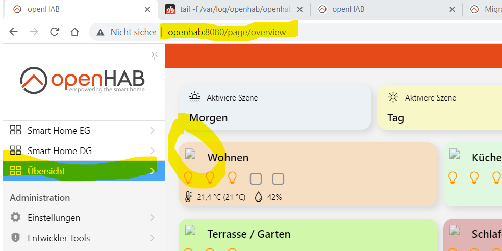

If I open the same overview page or any other page from the sidebar (with “/page/…” in the URL) the icons are not displayed

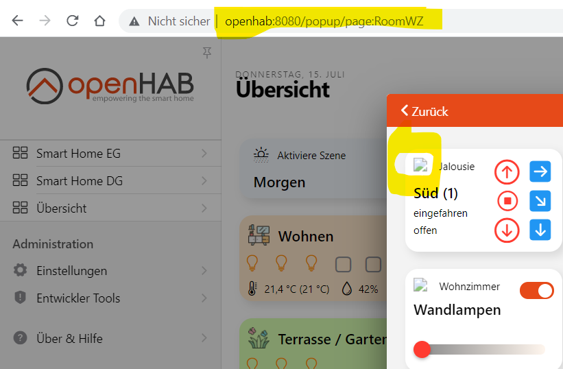

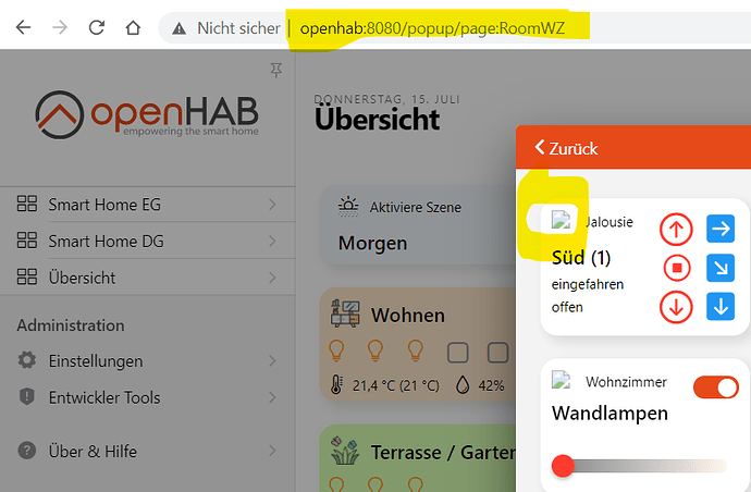

Within popup pages the icons are not displayed

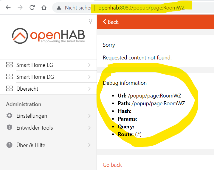

when I do a refresh on a popup page I get an error message
