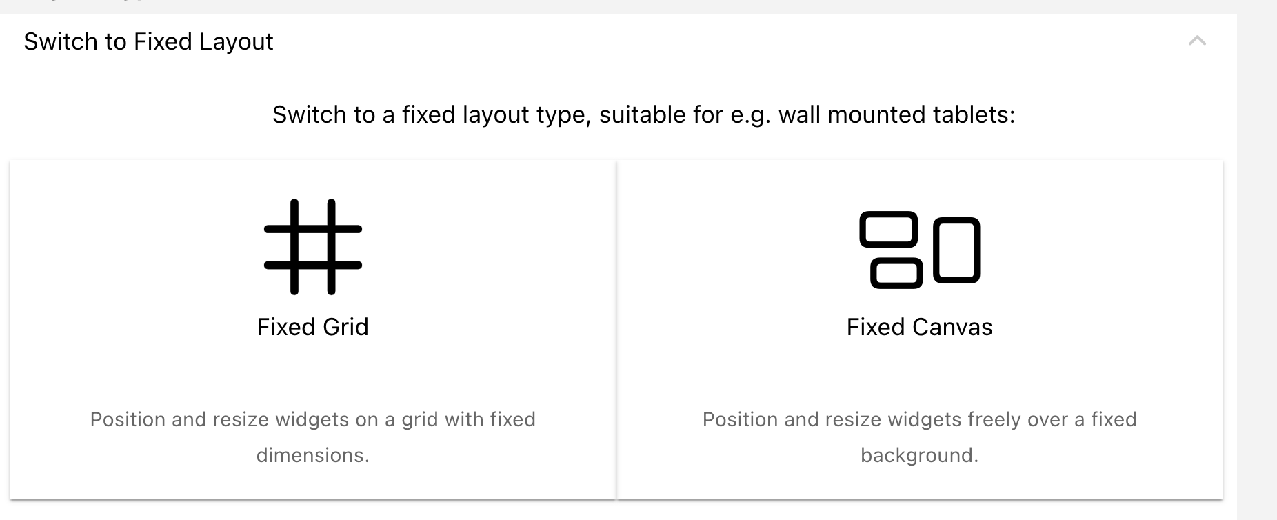

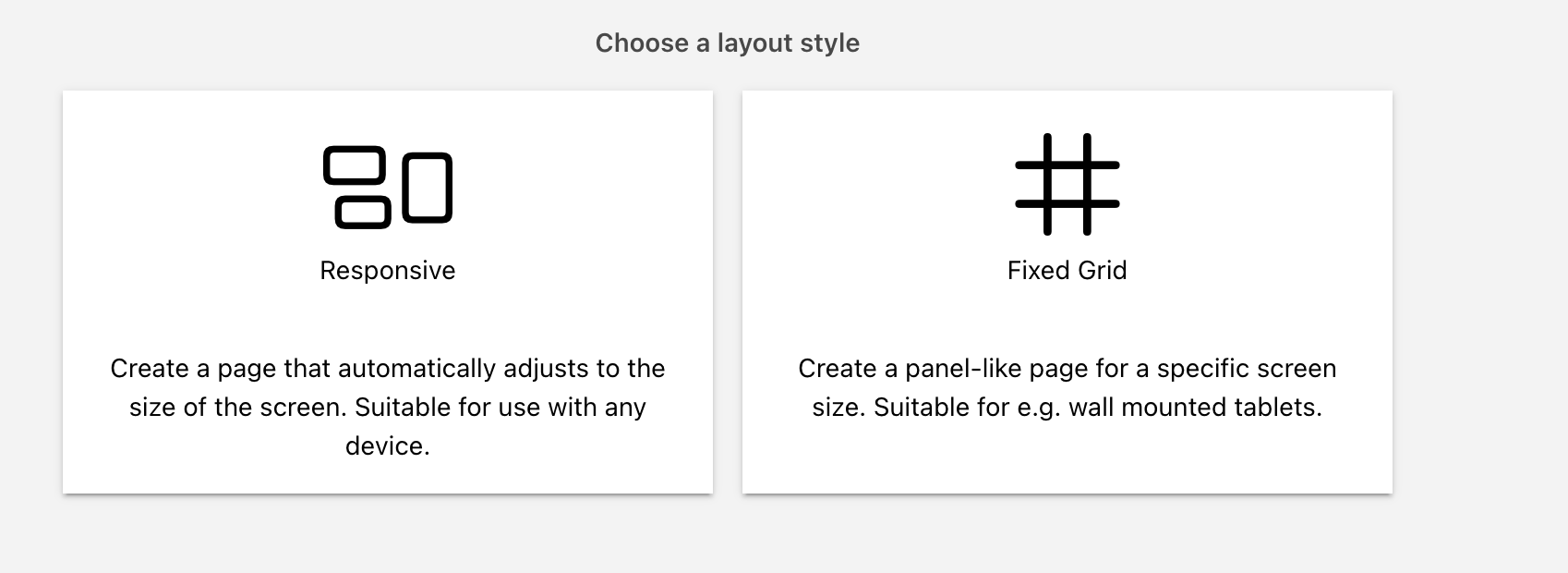

Ok (I had conflicting changes in my merge which overwrites your changes, sorry),
so it was changed from
to
Hence, it completely “replaces” the “fixed grid” and is an enhancement?

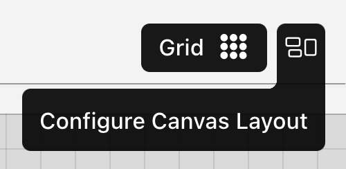

The difference I see compared to M1 (I have M1 on production and M3 as a dev server) is this
M1 :
M3:

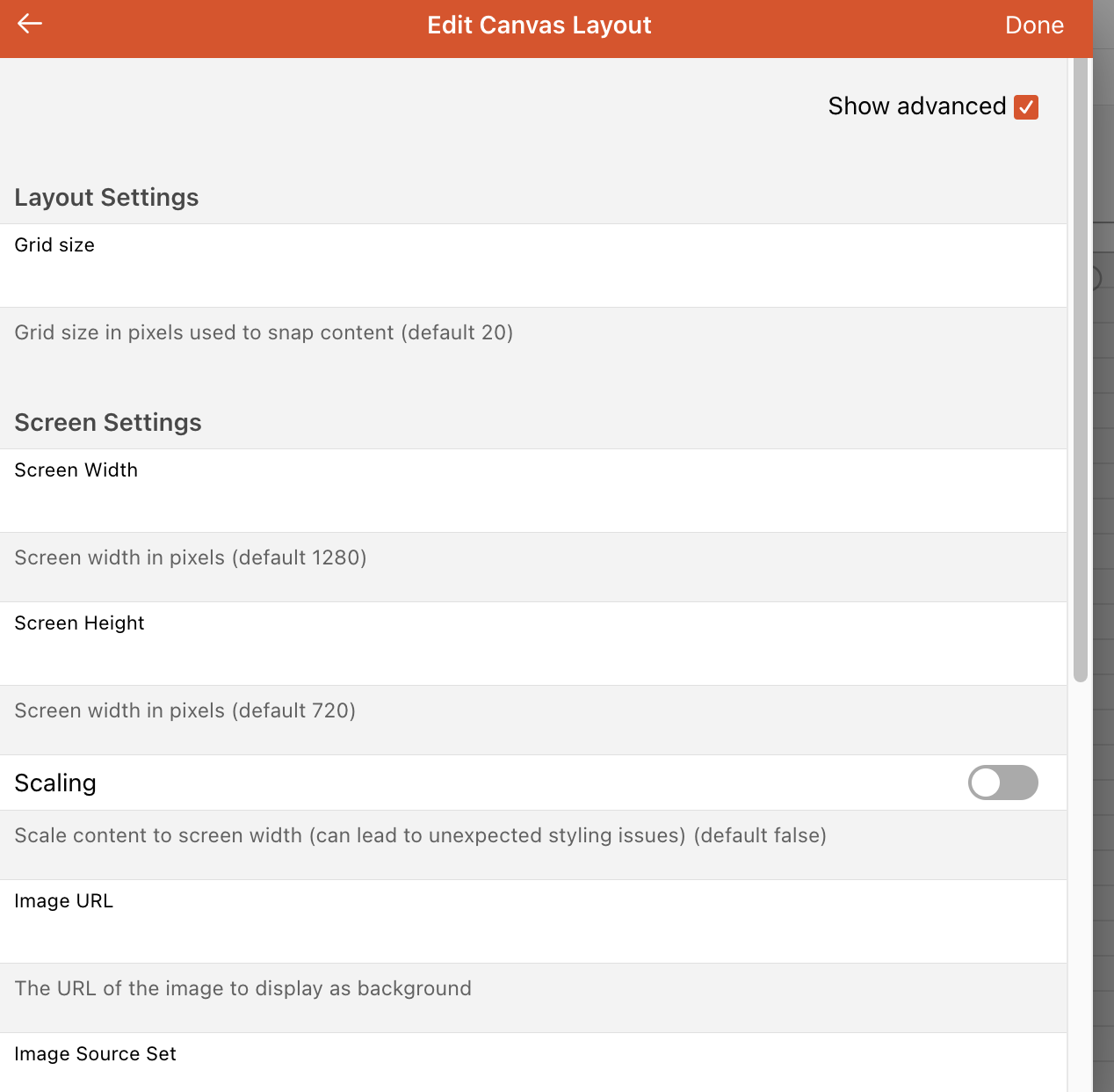

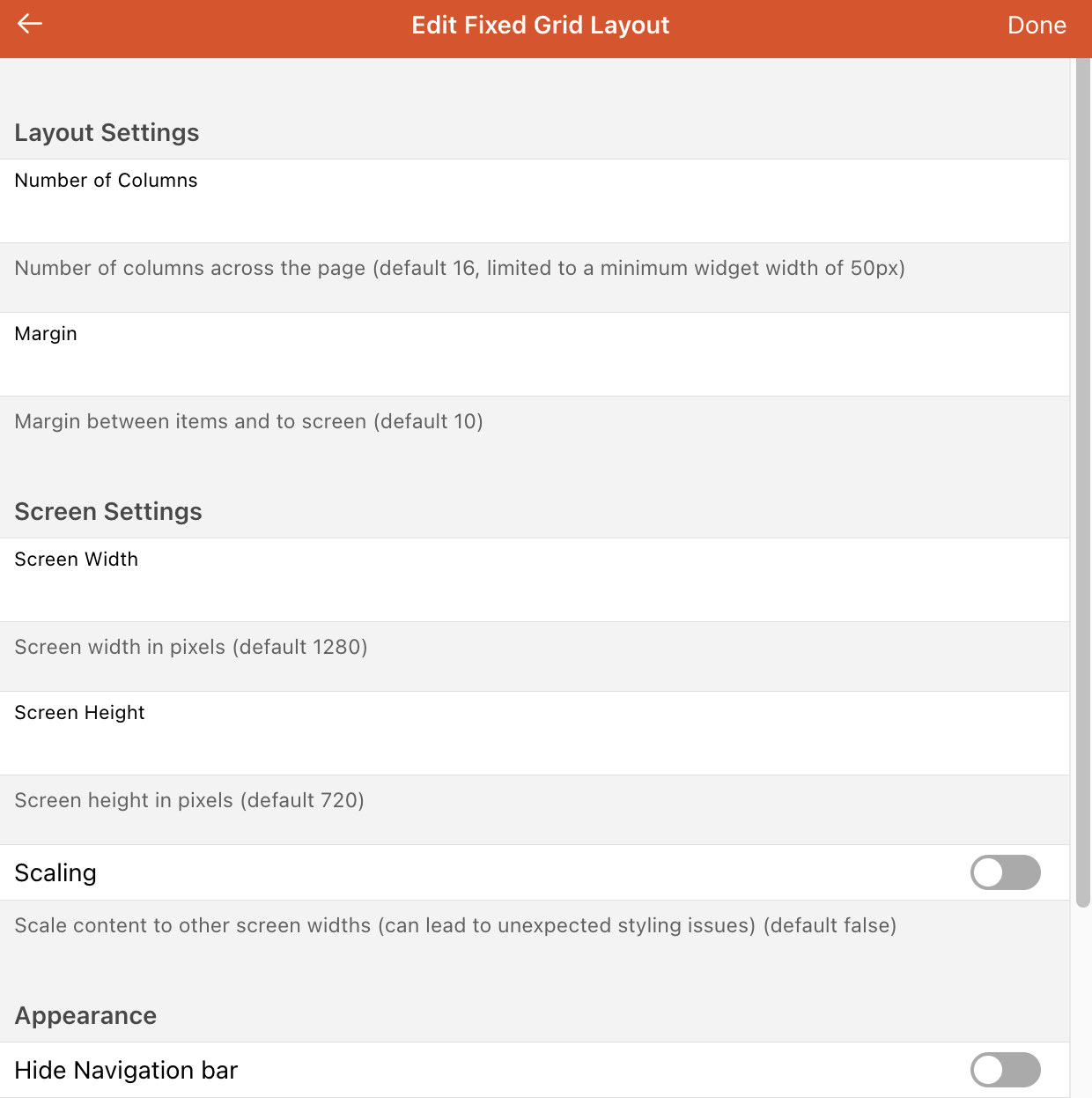

but the “magic” may lie in the config:
M1:

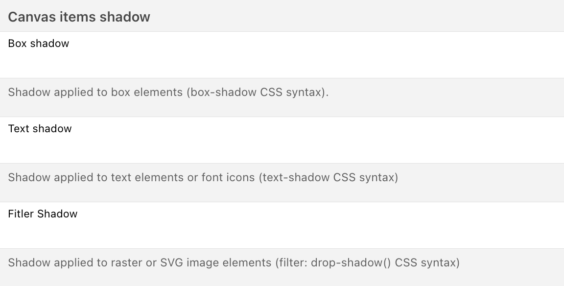

M3: the “Number of columns” and “margin” went away and more settings for Canvas
Is this compatible for people who have used columns and margin before?
No, the fixed grid layout remains as it was before, and fixed canvas is an addition. It is just that fixed grid layouts are less prominent in the UI to be chosen. If you had existing fixed grid layout, they should be totally unaffected (if not the case please give feedback as I must admit not having checked that).
For canvas layout, placement is completely free and user defined so there is no notion of lines or columns. You do have a grid pitch setting but it is just for temporary edition with a snap to grid feature. It will not affect anything that has already been placed.
