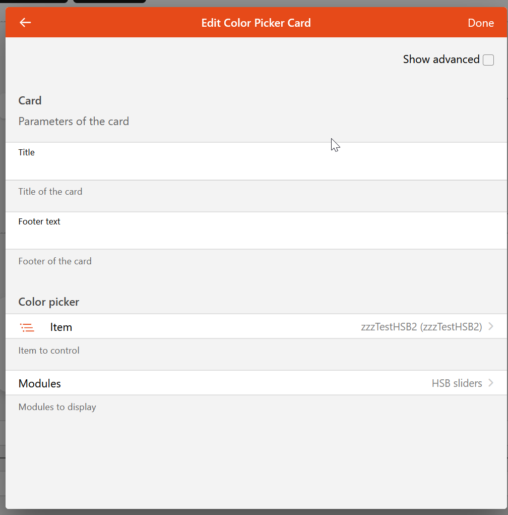

Edit: Removed content of original post to keep this thread clean.
Post with issue regarding colorpicker widget moved to it’s own post.
That is your answer to if this needs a new thread. This thread people want to know what the current 3.2 Milestone is like. Create your own thread and be sure to mention what web browser you are using and have tried other ones to compare. Do not reply in this thread.

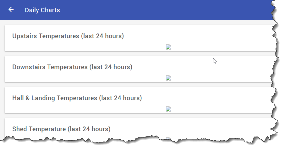

Can you open a GitHub webUI issue if not already done please. Always handy to get issues raised and fixed when code is fresh in people’s minds as there were some changes made to the icon system in 3.2
I am wondering if this is related to M2 (the timing makes me suspect that it is)..
