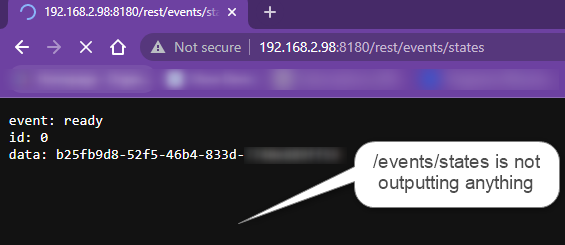

Can you show the query that is used by nodered?
Not sure what you mean by query @J-N-K , but in node red we have several nodes, and one of them listens for state changes as a way to initiate a flow, or rule, if you will.
When deploying / starting the nodes, they will “query” or “read” the states of the devices to which we set them up to.
So for example, if I have a rule that starts whenever the state of the kitchen light changes, and I deploy that, the current state of the light would be read, and updated whenever it changes.
Currently the problem is that it is being read only once. No further updates after that first one is received.
Yesterday the dev of the nodered-contribute-openhab3 node sent an update, but it didn’t fix the issue, at least in my case.
Further discussion here: https://github.com/jeroenhendricksen/node-red-contrib-openhab3/issues/38
I have no insight on nodered. I can only guess that it uses the REST API and SSE events. So I need to see the call to the REST API and also the m

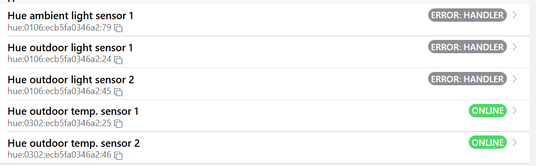

Problems with Hue Things after change to 3.3 from 3.2 (openHABian)
Detailed
Maybe you have the same issue, as I had with my ZWave Controller. I had to change 0 to false in the thing configuration (Code):
I would assume, that you have (at least) to change ledindication channel to false, as stated in the error message. Maybe you have to change other channels too
This helped for me
Thx
 unfortunately still un-initialized.
The Led-Indication is off (and was)
 so I guess it is a wrong value in the device-database.
Can you send the Code of the Thing?
Maybe there are more channels to change?
MAybe you can have a look in openhab.log and paste output
(The timeslot when the thing goes tries to go online)

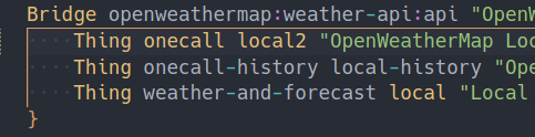

I double checked all my things manually, which took a lot of time. I found an issue within my Openweathermap things definition. I used “local” two time. Changing one to “local2” solved the issue.
So the error message “Last segment must not be blank” is misleading. Furthermore it would save so much time, if the error message would tell me the filename and line in which the error occurs or at least some other hints like binding name.

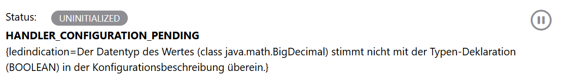

Hi, XXX is my bridge ID
UID: hue:0106:XXX:79
label: Hue ambient light sensor 1
thingTypeUID: hue:0106
configuration:
  tholddark: 3
  ledindication: 0
  tholdoffset: 100
  on: true
  sensorId: "79"
bridgeUID: hue:bridge:XXX
I disabled and enabled, so
2022-06-28 20:33:54.705 [INFO ] [ab.event.ThingStatusInfoChangedEvent] - Thing 'hue:0106:XXX:79' changed from OFFLINE (CONFIGURATION_ERROR): Es wurde kein Sensor mit der angegebenen ID an der Hue Bridge gefunden. to UNINITIALIZED
2022-06-28 20:33:54.738 [INFO ] [ab.event.ThingStatusInfoChangedEvent] - Thing 'hue:0106:XXX:79' changed from UNINITIALIZED (HANDLER_CONFIGURATION_PENDING): {ledindication=Der Datentyp des Wertes (class java.math.BigDecimal) stimmt nicht mit der Typen-Deklaration (BOOLEAN) in der Konfigurationsbeschreibung ĂŒberein.} to UNINITIALIZED (DISABLED)
2022-06-28 20:33:56.481 [INFO ] [ab.event.ThingStatusInfoChangedEvent] - Thing 'hue:0106:XXX:79' changed from UNINITIALIZED (DISABLED) to UNINITIALIZED (HANDLER_CONFIGURATION_PENDING): {ledindication=Der Datentyp des Wertes (class java.math.BigDecimal) stimmt nicht mit der Typen-Deklaration (BOOLEAN) in der Konfigurationsbeschreibung ĂŒberein.}
2022-06-28 20:33:58.618 [INFO ] [ab.event.ThingStatusInfoChangedEvent] - Thing 'hue:0106:XXX:79' changed from UNINITIALIZED (HANDLER_CONFIGURATION_PENDING): {ledindication=Der Datentyp des Wertes (class java.math.BigDecimal) stimmt nicht mit der Typen-Deklaration (BOOLEAN) in der Konfigurationsbeschreibung ĂŒberein.} to UNINITIALIZED (HANDLER_MISSING_ERROR)
What is misleading here? the expected value is a boolean, so true/false not 0.
set ledindication: false
and try please
Wow, you 're right
 i was not able to do so in the GUI but it can get fixed manually in the yaml! :grinning:
Irritating - but solved.
So the upgrade process isnt that easy.
Thx a lot

Have you guys checked the API explorer?? I don’t think it’s working
Starting to get a feeling that the Node Red issue might be related to this??
Isn’t it possible to consider a default header value if no value is provided?
