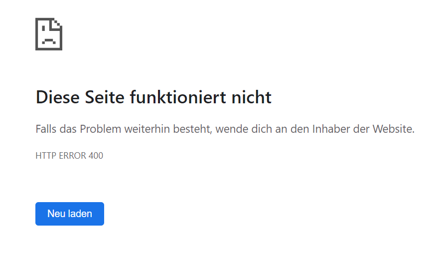

I updated to OH 3.3.0 now I can’t access ITEM State thru API anymore.
I tried the following URL in Browser (CHROME):
http://192.168.10.150:8080/rest/items/i_TestITEM/state
with version 3.2.0 I was able to get the state. Now I receive:

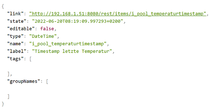

Request all for a item works with:
http://192.168.10.150:8080/rest/items/i_pool_temperaturtimestamp
curl on Linux works also:
curl http://192.168.10.150:8080/rest/items/i_pool_temperaturtimestamp/state
2022-06-20T08:19:09.997293+0200
But I only need the state as output in Browser (Chrome) Window
Does anyone has an idea what I could try?
I have the same issue as @Pedro_Liberal, openhab items in node-red just have updates on deploy, events node is working tho.
@helmar74 try using postman, you need to pass credentials to be able to get the state (at least I tested on Postman with credentials and it worked perfectly)
It is working on linux with curl, without credentials. It looks like the API has changed and the /state URL isn’t workin anymore in browser.
I also can get all values in a request without sending credentials
I tested postman, that worked, but not in Chrome
 Strange

The reason probably is that the browser requests a content-type that is not available. Safari adds a Accept: text/html,application/xhtml+xml,application/xml;q=0.9,*/*;q=0.8 header and none of these can be provided by the REST API. That’s why a “400 Bad Request” is returned. This was not properly checked before (in fact the header was ignored), but is now handled correctly to ensure that binary data can be provided in the correct format (https://github.com/openhab/openhab-core/pull/2825). The correct content-type for the request is text/plain. You have to add that to your request or omit the Accept header.
Can you please Provide a example URL?
Best would be for Chrome :wink:
I’m not aware of a possibility to set headers for normal requests in browsers. It should be possible with tools like Postman or Paw (on Mac) and of course with JavaScript.
Edit: It seems for Chrome and Firefox there are tools that can achieve it: https://stackoverflow.com/questions/7097502/view-and-set-http-headers-for-safari-chrome

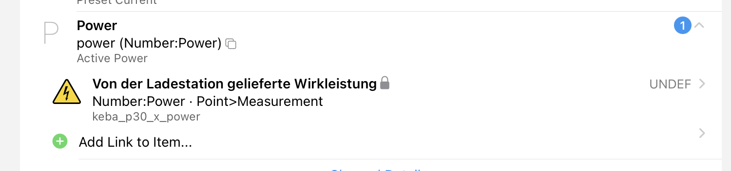

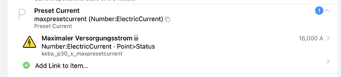

Had big hope that the KEBA Binding problem will solved with 3.3, but it is still the same. All other values are set, but power stays at UNDEF. I activated the DEBUG Level and got for all reports the complete values. So the binding still have a problem, when the item is defined over a file. Setting the same over the UI, works. Debug:
[DEBUG] [internal.handler.KeContactTransceiver] - Sending 'report 1' on the channel '/192.168.***.***:39819'->'/192.168.***.***:7090'
[DEBUG] [internal.handler.KeContactTransceiver] - Received {
"ID": "1",
"Product": "KC-P30-xxxxxxxx-M0R",
"Serial": „xxxxxxxx“,
"Firmware":"P30 v 3.10.36 (211117-093932)",
"COM-module": 1,
"Backend": 0,
"timeQ": 3,
"DIP-Sw1": "0x22",
"DIP-Sw2": "0x00",
"Sec": 6905050
 from /192.168.***.***:7090 on the transceiver listener port
[DEBUG] [internal.handler.KeContactTransceiver] - Sending 'report 2' on the channel '/192.168.***.***:39819'->'/192.168.***.***:7090'
"ID": "2",
"State": 2,
"Error1": 0,
"Error2": 0,
"Plug": 7,
"AuthON": 1,
"Authreq": 0,
"Enable sys": 1,
"Enable user": 1,
"Max curr": 16000,
"Max curr %": 266,
"Curr HW": 16000,
"Curr user": 16000,
"Curr FS": 0,
"Tmo FS": 0,
"Curr timer": 0,
"Tmo CT": 0,
"Setenergy": 0,
"Output": 0,
"Input": 0,
"Sec": 6905053
[DEBUG] [internal.handler.KeContactTransceiver] - Sending 'report 3' on the channel '/192.168.***.***:39819'->'/192.168.***.***:7090'
"ID": "3",
"U1": 235,
"U2": 235,
"U3": 231,
"I1": 0,
"I2": 0,
"I3": 0,
"P": 0,
"PF": 0,
"E pres": 68653,
"E total": 29752553,
"Sec": 6905056
Number:ElectricCurrent      keba_p30_x_maxpresetcurrent         "Maximaler Versorgungsstrom [%.3f A]"                      <energy>     (gKEBA)    ["Status", "Current"]         {channel="keba:kecontact:1:maxpresetcurrent"}
Number:Power                keba_p30_x_power                    "Von der Ladestation gelieferte Wirkleistung [%.1f Wh]"    <energy>     (gKEBA)    ["Measurement", "Power"]      {channel="keba:kecontact:1:power"}
