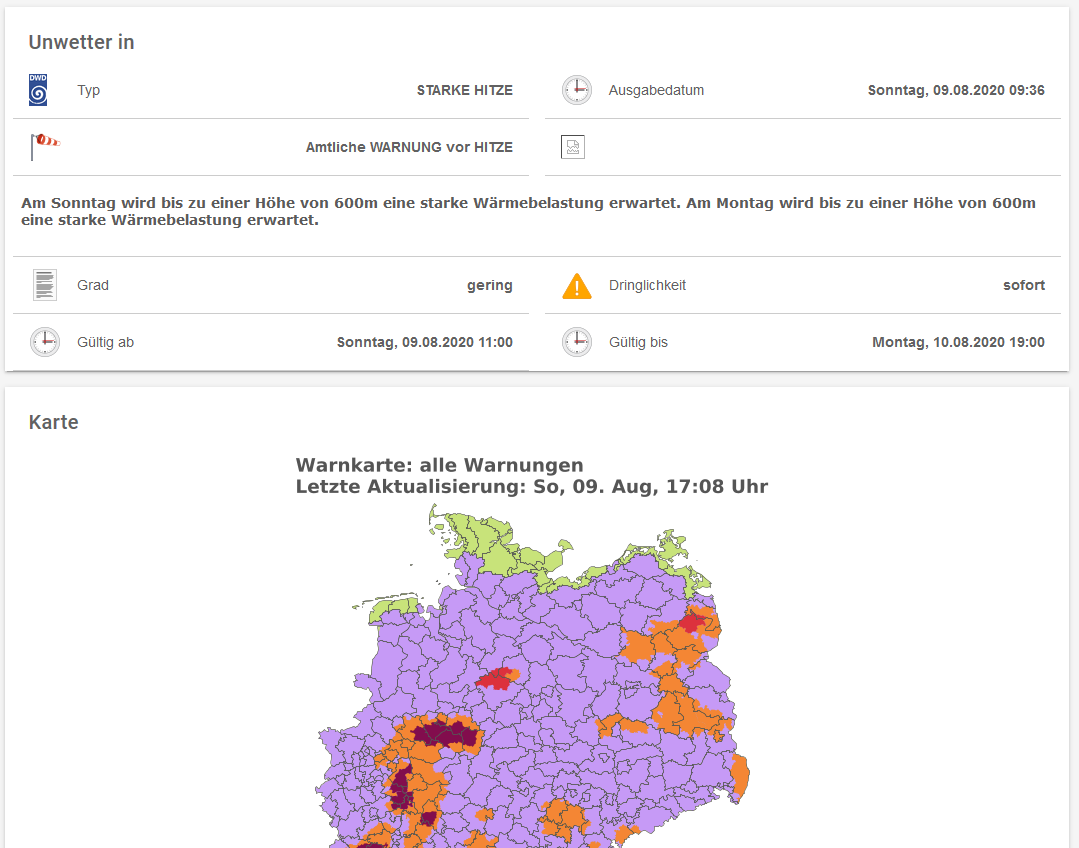

I have the same problem like many others. In the “DWD Unwetter Binding” is the text of the description often to long for the Sitemap. So I searched for a solution.
I found some ideas, like put everythin in frames or something else. That was all not what I have seached for.
Now maybe I have a better solution.
I take via REST from the “Beschreibung” item the JSON value from “state” which is the description. The Transform this in a html file and display it with the webview in my sitemap.
The style is not perfect at the moment. And because I have never worked with html or css previously the code is probably not well.
This my code:

from where did you pull the map image? :smiley:
Also looking at your html I see that you refer to a local script source with the ending jsm?
The image are from the DWD:
https://www.dwd.de/DWD/warnungen/warnapp_gemeinden/json/warnungen_gemeinde_map_de.png
https://www.dwd.de/DWD/warnungen/warnstatus/SchilderSU.jpg (this ist also for the other german states available.
