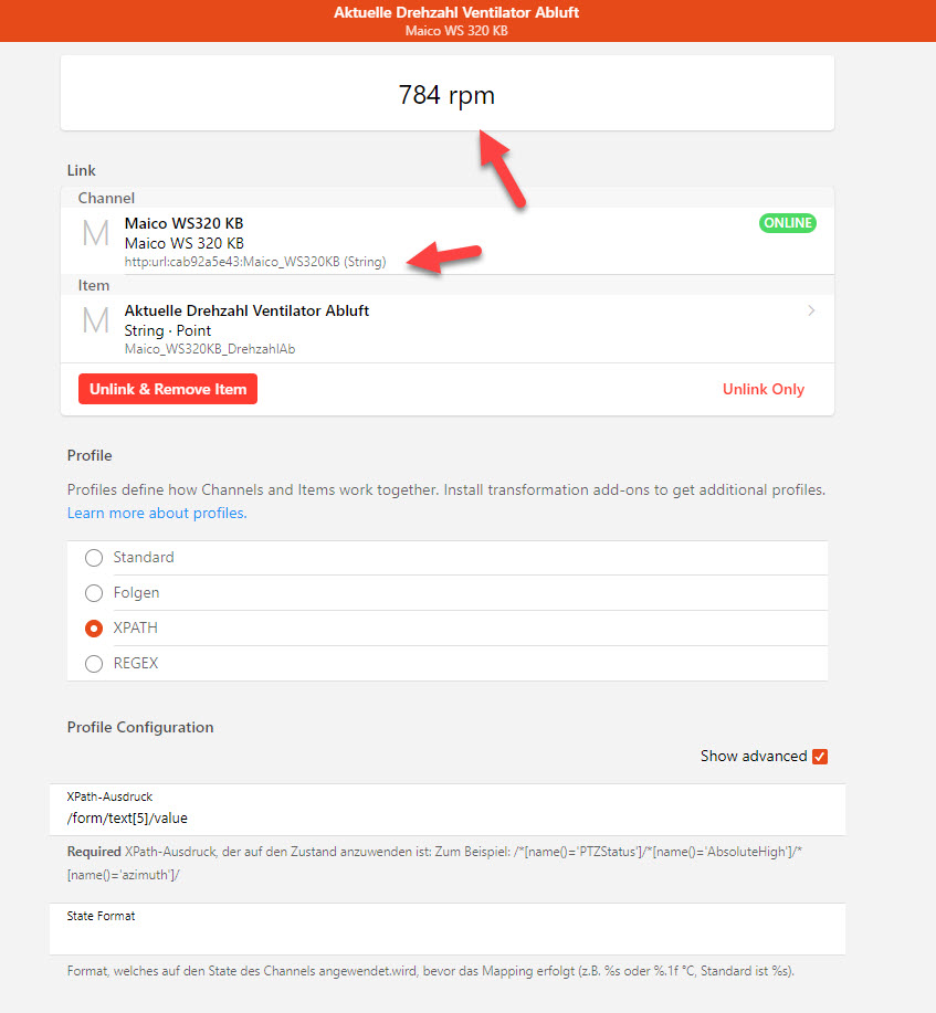

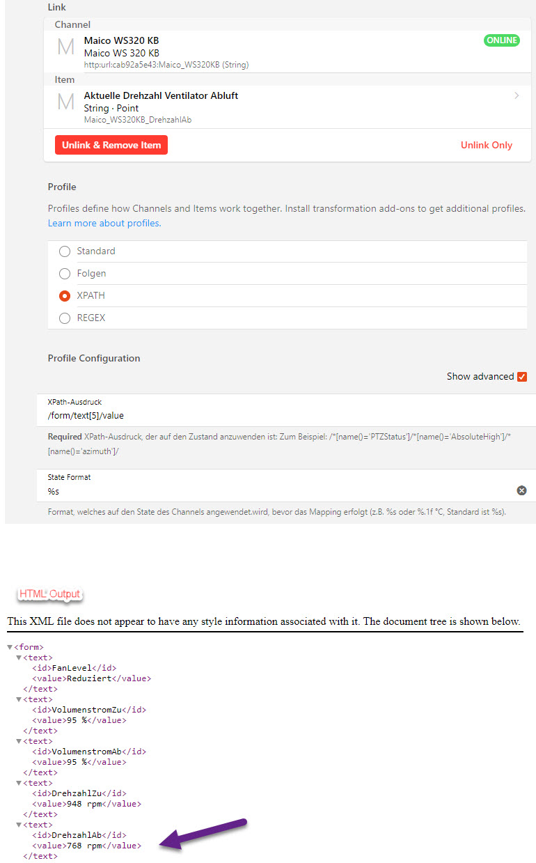

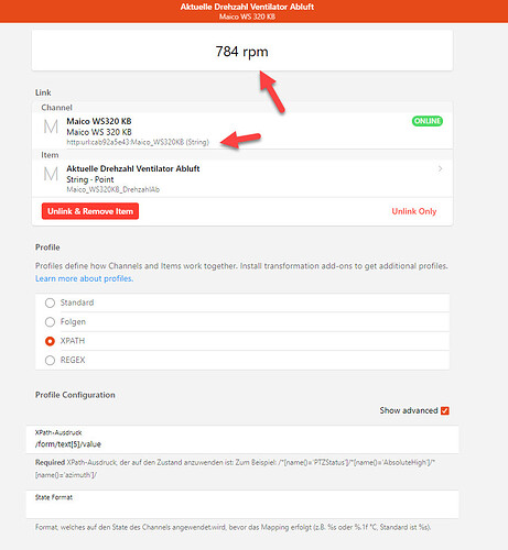

i am using the openHAB 3.3 Version with a HTTP-Binding to read out data from a HTML page with x-path.
Now i read in the value 123 rpm. But now i cannot declare this in the Channel as “Number” because it contains not only the 123 rather also rpm. Now the question if there is a possibility to remove all except numbers from the read in x-path?
Can anybody helps me? if i define the x-path as “String” all working fine. when i define as “number” i get NULL back.
i have attached a screenshot here.
thank you so much!

For the most part, screen shots are useless to us. Please click on the code tab and paste what you find there when trying to show what you’ve done.
But like I said above, you can chain transformations so chain youer XPath to a REGEX (something like REGEX:(.*) rpm should work assuming the XPath is returning what you think it is).
