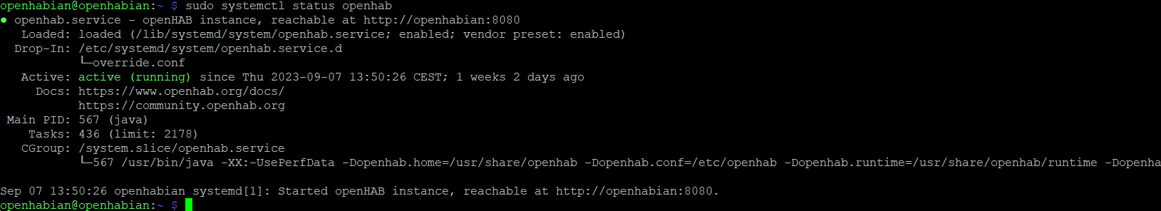

I am running OH 3.4 on PI3 using openhabian.
The problem is that every few weeks the GUI interface stops responding.
When it happens, OH3 works fine, receive commands and sends commands, send email and notifications, SSH works fine, Karaf is accessible, but the IP:8080 do not connect.
Also HTTP API do not work (HomeHabit & HabPanel do not connect) and sitemaps do not work (even if in the logs the cloud connector is connected)
2023-09-16 17:36:59.263 [INFO ] [io.openhabcloud.internal.CloudClient] - Disconnected from the openHAB Cloud service (UUID = ee...ea, base URL = http://localhost:8080)
2023-09-16 17:37:00.445 [INFO ] [io.openhabcloud.internal.CloudClient] - Connected to the openHAB Cloud service (UUID = ee...ea, base URL = http://localhost:8080)
Apparently everything is fine, but GUI, sitemaps do not work.
logfiles do not show anything related to this behaviour.
Any idea?
How can I restart the HTTP services of OH3 without restarting OH itself?
