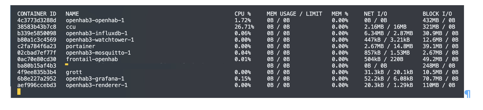

What does the docker logs command show for your openhab container ?
What does the command docker stats show when you monitor it between restarts ?
docker stats say:
