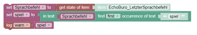

As a workaround i tried to use the last voice command channel to detect playing music. But this didnt work…
2023-07-27 08:25:55.791 [INFO ] [openhab.event.ItemStateChangedEvent ] - Item 'EchoBuro_LetzterSprachbefehl' changed from alexa to spiel donau drei f. m.
2023-07-27 08:25:55.804 [ERROR] [internal.handler.ScriptActionHandler] - Script execution of rule with UID '6cf0271241' failed: TypeError: Sprachbefehl.indexOf is not a function in <eval> at line number 7
