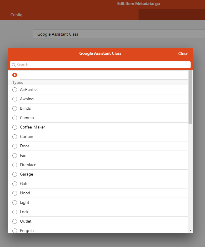

I have also used main ui to see if it can give me any clues. From what I have read the Alexa integration is being rewritten however I have no idea how that project is going.

@denominator Thanks, got this working now by following your post, Main UI, edit each item and add some Google meta data. Works fine.
@Tara_Wood-Bradley there’s an option in the metadata page called auto update, not sure if this is related to the issue you have. I dont have that issue, Google updates its status when I change an item in the Main ui or from myopenhab.org.
