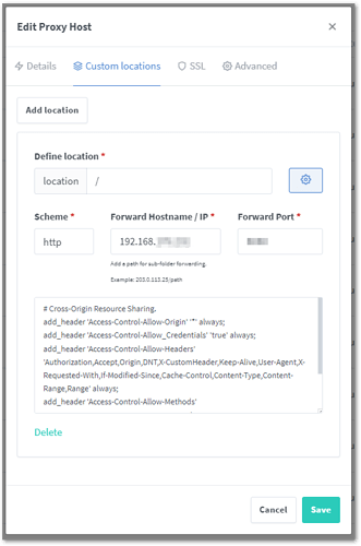

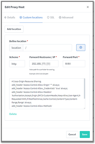

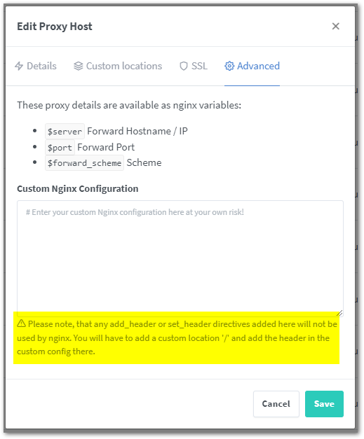

I had some problems with enabling/disabling things via ui using the Nginx Proxy manager.
I have added a custom location with some additional header entries, i was using within openhabian befor using nginx proxy manager.
