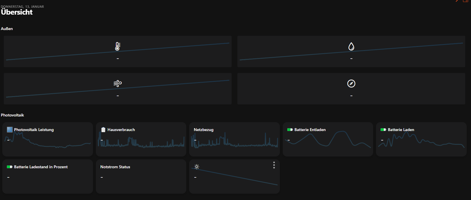

The migration worked and openhab stared as expected. Also all things are online. On some pages I displayed some cells with graphs and the value (standard openhab cell).
As I look into the graphs the recording of values works.
But the only problem: All values in the cells are not displayed anymore, but only in Google Chrome (Firefox works).
I already deleted the cache and all browser data.
Does anybody know where the problem can be?
Ok.. Just solved the problem.
There was an issue with my ssl certificat.
