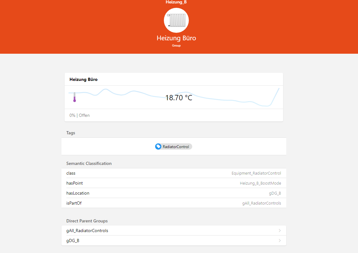

Hey,
I´m still migrating to oh3 and have an Problem with my textual items für Heating. (Homematic IP)
I Use the textual because i move soon to my new House, and then there could be a lot of Bulk changes.
My RadiotorControls have 2 Groups one is from type Equipment too and all RadiatorControlls are in gAll_RadiatorControls and a Location for Example gDG_B. for my Office
This works good when i dont restart my System on every restart All of them loose there Location. but are still in the Equipment Group.
The Group is still shown in MainUI but is no longer shown as Location
When i remove the location in the item File → Save and add it again the Location is Back.

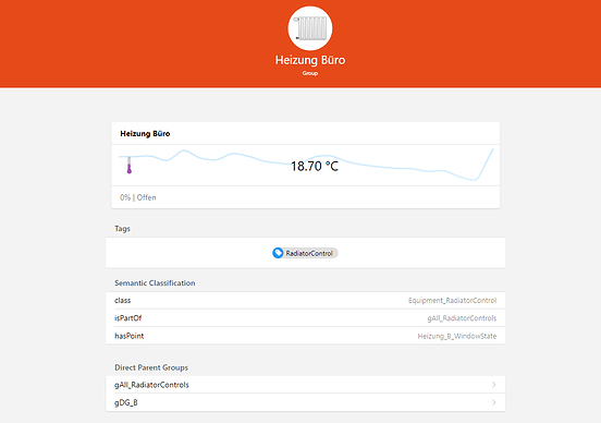

After Restart:

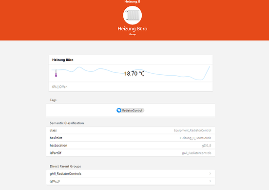

After Adding Group Again:
i also wonder about the about the hasPoint Field in MainUI, it only shows one of the Points added to the Equipment.
My items looks like this:

did i something wrong or is this only an issue due textual Configuration ?

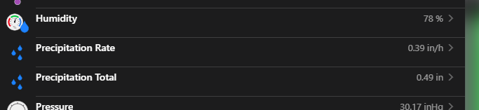

I am having a similar issue. I have one manually configured item, because I need to change the rate rate from mph to in/hr. It shows in the Weather location just fine until I reboot. Then it is missing from there. I can unlink it and re-link it by renaming the file to .old and then rename it back. As soon as I rename it back, it is back in the location box.
PWSData_PrecipitationRate.items
Number:Speed WC_PWS_PrecipitationRate “Precipitation Rate [%.2f in/h]” (Weather)[“Measurement”, “Rain”] { channel=“weathercompany:weather-observations:2161118650:e93740655e:currentPrecipitationRate” }
