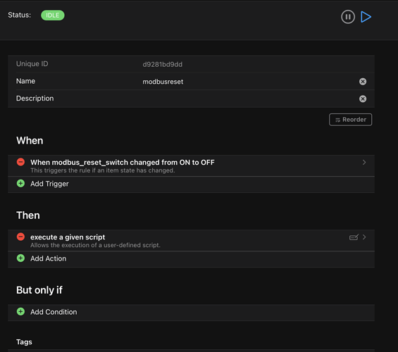

I have rule, that executes command line when item change state:
script is DSL rule:
executeCommandLine(Duration.ofSeconds(6),"/etc/openhab/scripts/resetmodbus.sh")
Why it is not working??
