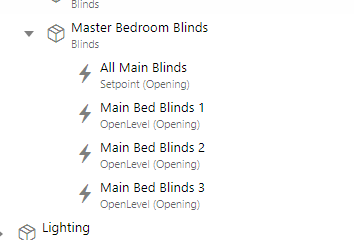

I have 3 windows in my master bedroom.
Each window has blinds which are controlled using a dimmer
These are in a group. My group i want to have an average of the dimmers.
When i set this. If i adjust any of the blinds. the average is working for the group. but its almost as if its using sendCommand instead of postupdate.
In oh2, the group average would update fine, but in Oh3, the group average updates, but the blinds then start going from one percent to the next and back again, because every time the group average updates, its almost as if its sending the command again.
My oh3 setup in the main UI
My old OH2 setup in my .items file
Group:Dimmer:AVG blindsLoungelocation "Blinds [SCALE(blinds.scale):%s]" (mapDB)
