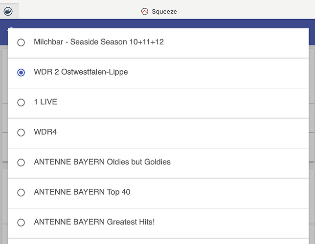

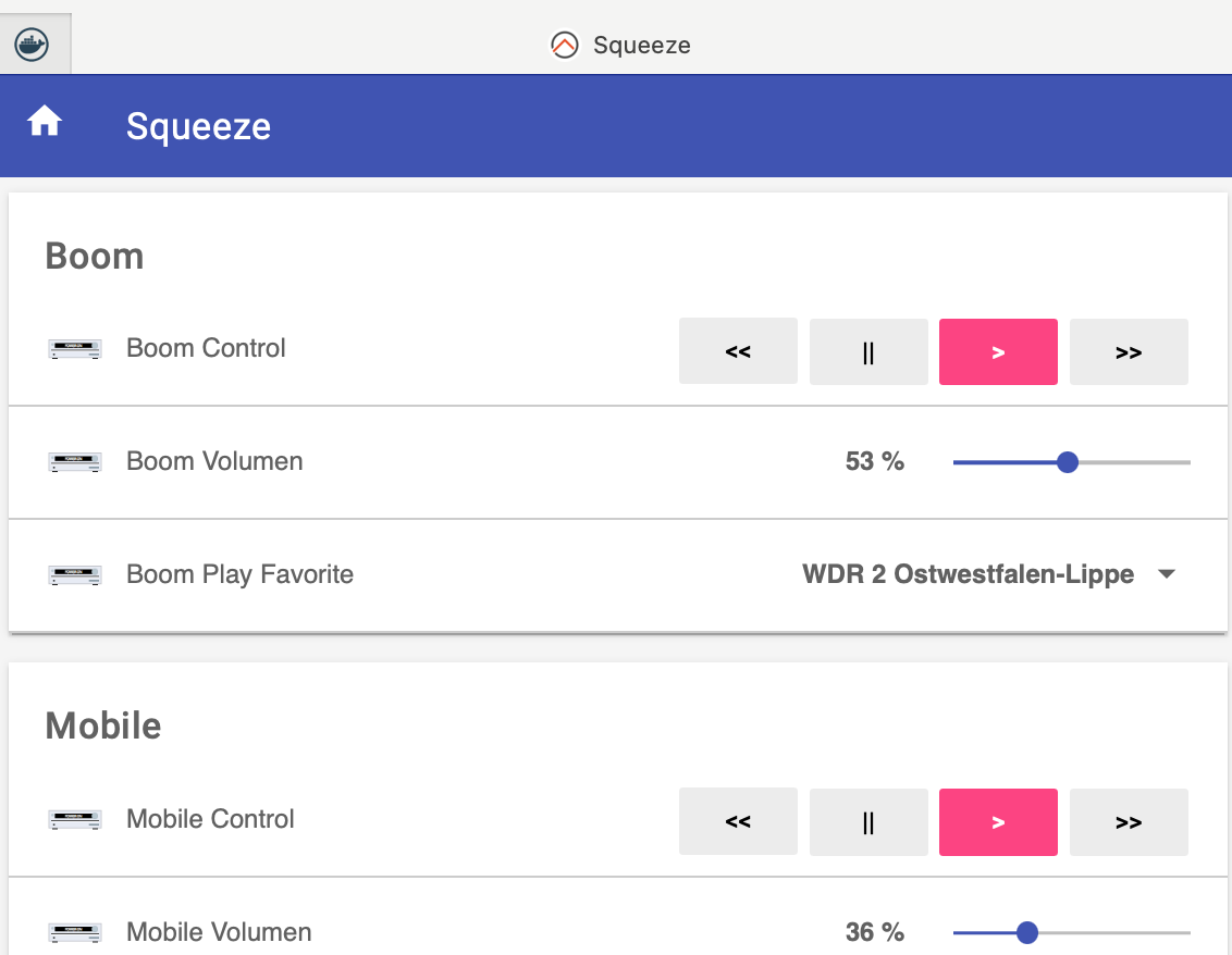

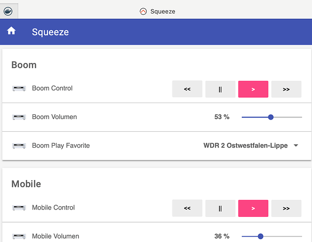

The squeeze Sitemap is working
A selection in the sitemap is fine

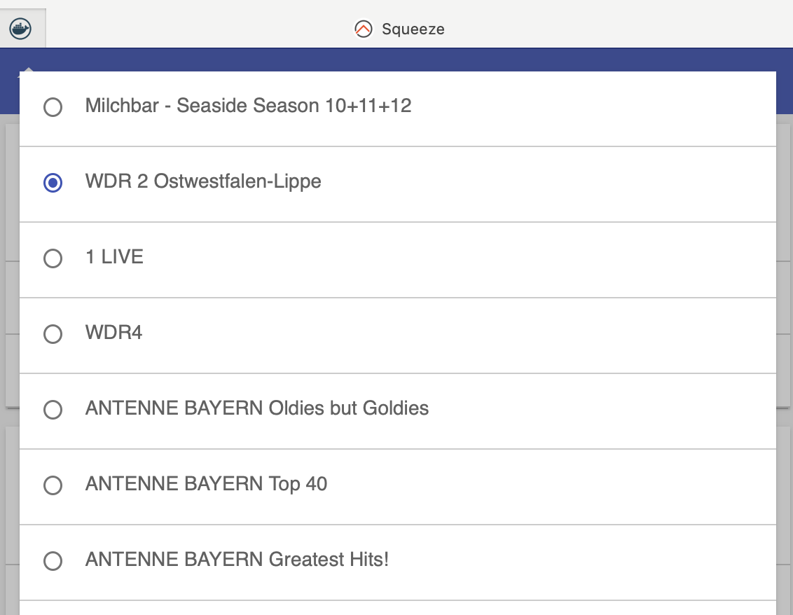

The layout:
I believe with the squeezebox channels the favorites are predefined. So this means that you can choose whichever widget you prefer that has the set of actions options. Set the action property to options and the actionItem to your favorites item (e.g., SPBoomPlayFavorite) and when you click on the widget you will be presented with a popup that lists all the available options for that item.
From your layout it seems that you might just want to use a label card (see the action options for a label card here) but you could just use a button or icon or any number of other choices. Many of the default widgets, cards , and cells have this functionality available.
One note if you use one of the predefined cell widgets: When you select the action option, a 3-dot context button will appear in the upper-right corner of the card (pressing this gives you access to the expanded card).
If you do not want this you must edit the cell’s YAML and add expandable: false to the config.

Ah, sorry I don’t use squeezebox so I asssumed that as the favorite channel as a string format it actually held the name of the favorite. If you navigate to the item page for this item, do you see the number or the Name at the top of the item page?
In the overview, I can see a number. If I klick into the item details, I can see the let say “display name”. Number 2 is “WDR 2 Ostwestfalen-Lippe”. Or Number 4 is “WDR 4” and so on…
