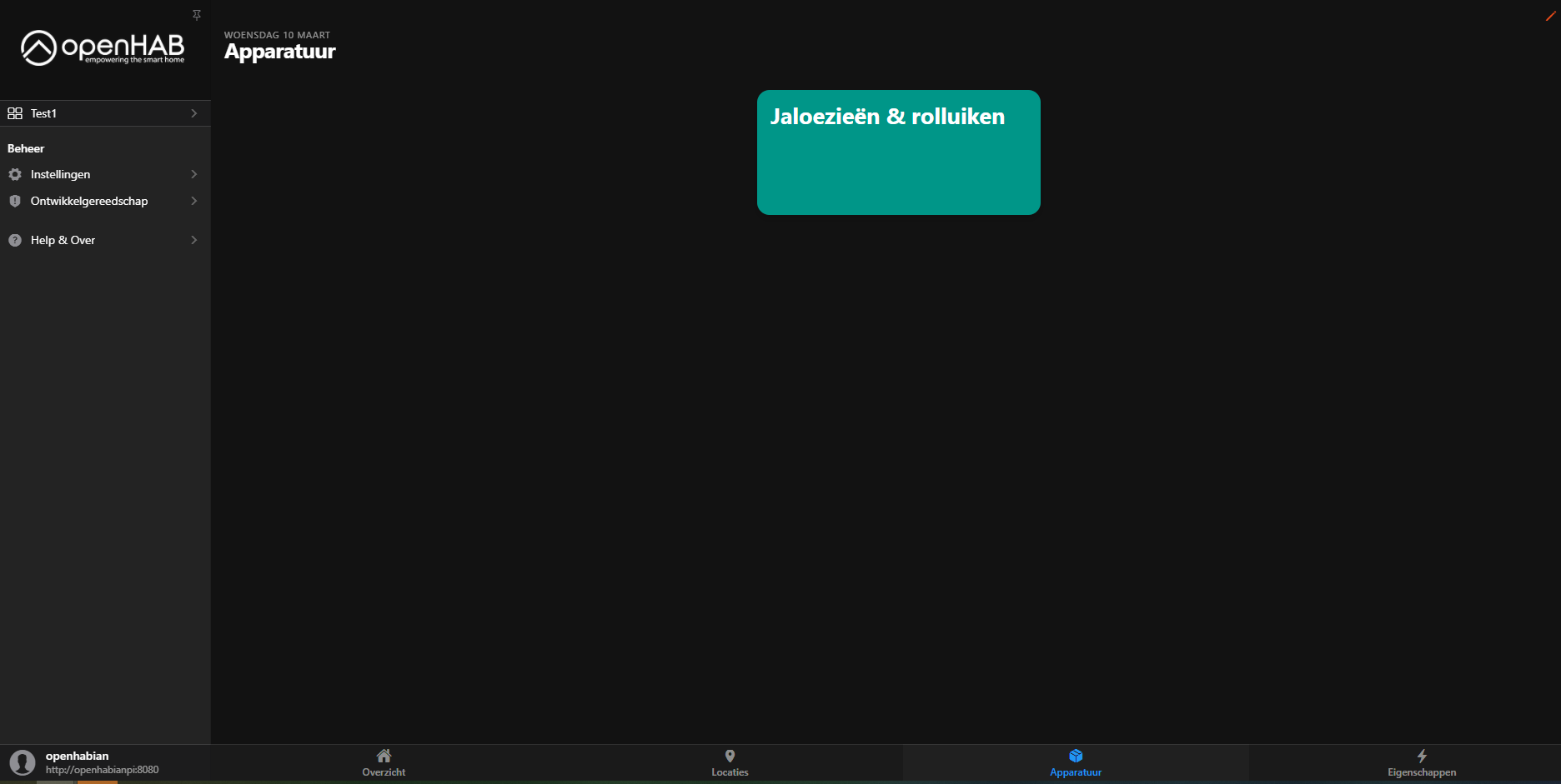

  • On the homescreen (by clicking openhab logo on top left)
    • overview and locations are empty.

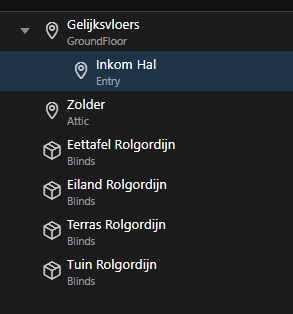

    • In devices i see my 4 blinds available in a category, thats it, no idea why these are automatically recognised.
So tried looking into Models - and adding new locations.
I can not use the same name as my groupname i used in home.items file.
I also notice all the locations/ groups already beeing there if i check the non-symantic box.
I want to recreate what i have in my site map, First Floor (Eersteverdieping) - Office - item1/item2
I feel i need to do this with locations.

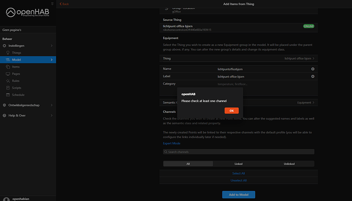

So i created a few new ones, but when adding the equipment.. i can not save it because there are no channels available to choose from, and i need to select at least one before it allows me to save.
Do i need models? According to the video these locations should have been updated automatically of my groups.

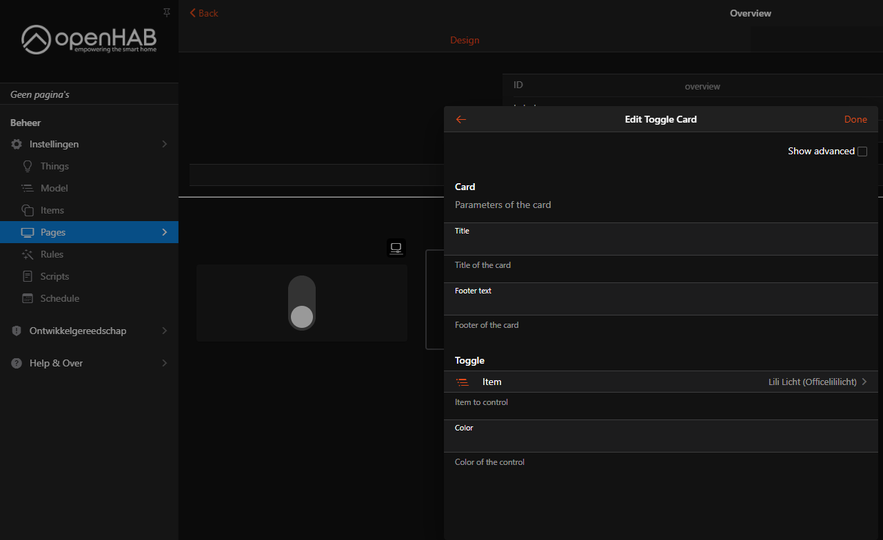

  • opened the overview page
    - added a toggle card
    But this item only turns my light ON, tho i can toggle it back to off, it does not turn my light OFF.
    This does still work via the old ways.

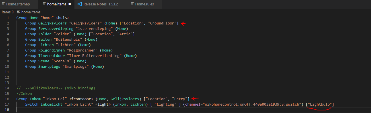

No, but if you want to use the Semantic Model via Items files you need to correctly ‘tag’ your relevant Items.
Dear @hafniumzinc
Thank you for the response.
that does seem to populate the models, i will start testing more.
i added it for a floor, a room and a switch.
first 2 worked.
The switch didnt, if i add the lightbulb or variants.. items and models shows empty untill i remove it again.
What is needed for a switch for a light please?
I am afraid that the tag [ “Lighting” ] that is needed for google is making this go wrong.
I’m not sure of the answer, but I don’t think you can split the tags like you have done. Get rid of your Lightbulb tag after the {...} and move it into your existing Lighting tag, though double check that they don’t interfere.

Now i still have the same issue as when i manually created a widget in the pages.
The button turns on the light, but it does not turn it OFF.
even in Frontail i see the ON appearing, but not the OFF.
Would you have any idea about this please?
Yes, probably this issue:
Try using a different device and/or browser
@hafniumzinc You are right again!
opened my mobile app, logged in to the 3.0UI, and here the button does toggle.
“dude” you are a god!

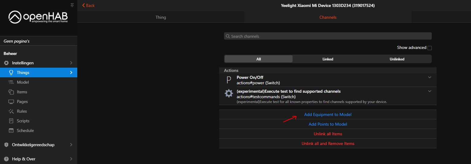

Yes, you still link Thing Channels to Items. If you’re not using Items files, easiest method is to use the ‘Create Equipment from Thing’ ‘Add Equipment to Model’ button when you’ve created your Thing: this is a visual method to create relevant Items (Equipment is just an Item).
@hafniumzinc thank you.
and with create equipment, you mean this button:
after clicking the thing you want to add as an item
Yes, that one - apologies, I got the name wrong!
