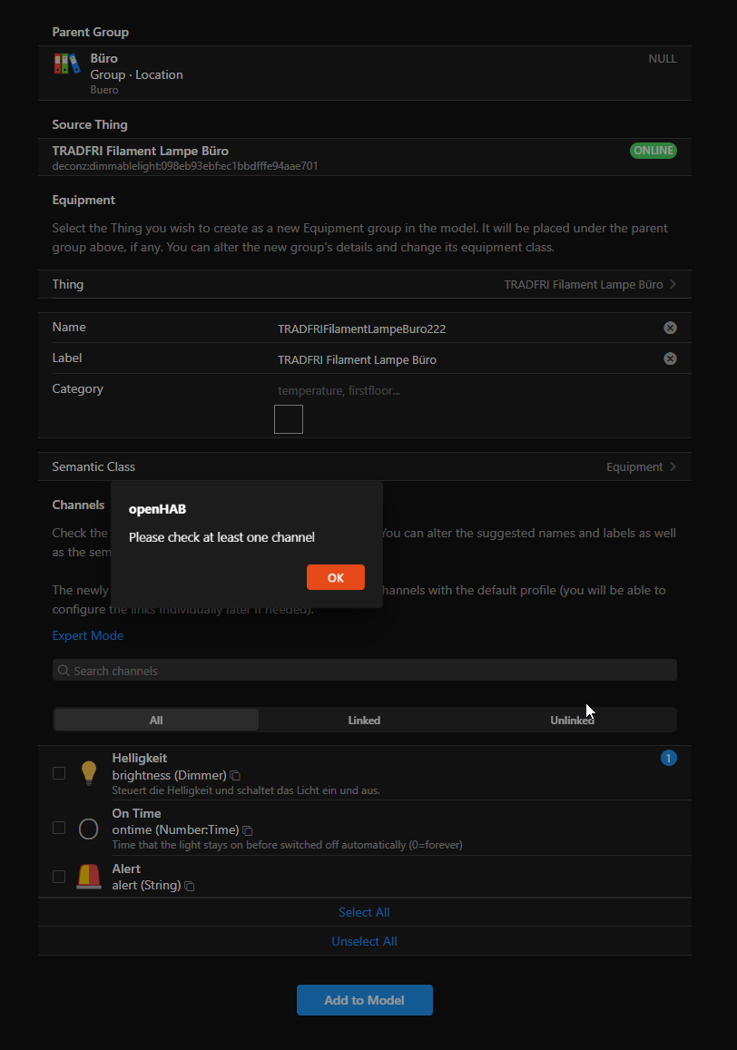

For example, I have an IKEA zigbee lightbulb, with a dimmer item attached to the dimmer channel of the lightbulb thing. Now, when I want to add the lightbulb to my model, I go to the location where that device/equipment group is supposed to be added to, I select “Add equipment from thing” and then I search for the existing thing.
I then select the channels that I want. In that view, as far as I can see it, there doesn’t seem to be a way to select already existing items. When selecting the channel and than pressing “Add to model”, I new item for the same channel is created:
What I thought might be possible to add the thing as an equipment and not select any channels, and afterwards go into the existing item and add it to that new group, but openHAB doesn’t allow me to do that.
So right now it seems like I have to delete the “old” thing from openHAB, even if it was created in OH3 with the new UI, and then create it again in the semantic model UI? Is that correct?
Please show us what you try, as it is definitely possible to change the group memberships at any time.
What I meant was I tried to go to “Add equipment from thing”, and then not select any channels. But that doesn’t seem to be possible. But I just might be misunderstanding the whole concept :slight_smile:
Not the whole but parts of it. Add equipement from thing is a helper to let you select up to all channels to add to an equipment. If you want to create an equipment without any items, just use "Create equipment.
In items settings, you can change the parent group membership at any time.

To show up under equipment, a point item needs to be part of an equipment group. Just that simple.
