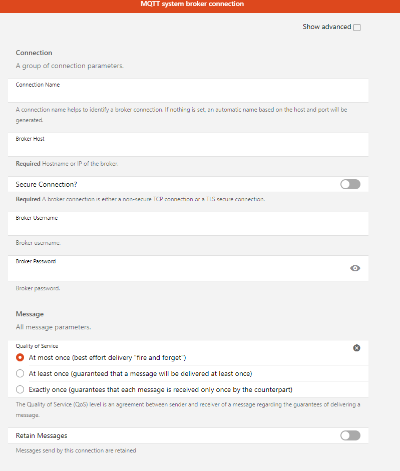

Hello, can you please help me? Openhab3 MQTT system broker connection screen is blank.
We would need more information to be able to help you @haybolat
What broker are your using?
How did you install your broker?
Is it this screen that is blank?

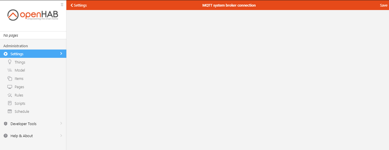

Yes
I reinstalled openhab3 2 times. It didn’t happen again, I don’t know where I’m making a mistake.
Ok that doesn’t look good

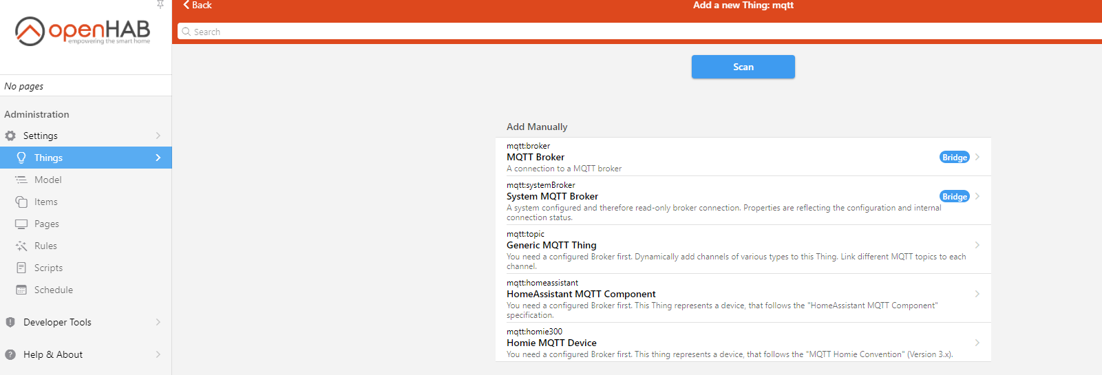

Install the MQTT Binding if you haven’t already then create a thing /broker
Yes, I just reinstalled. I did what he said before installing mosquitto. Thank you very much.

Again, the mqtt broker setting page is empty, I think this makes the system settings (locale and timezone) when the settings change.
Setting locale and timezone to default setting is fixed. This is a system error in my opinion. let us report it where.
