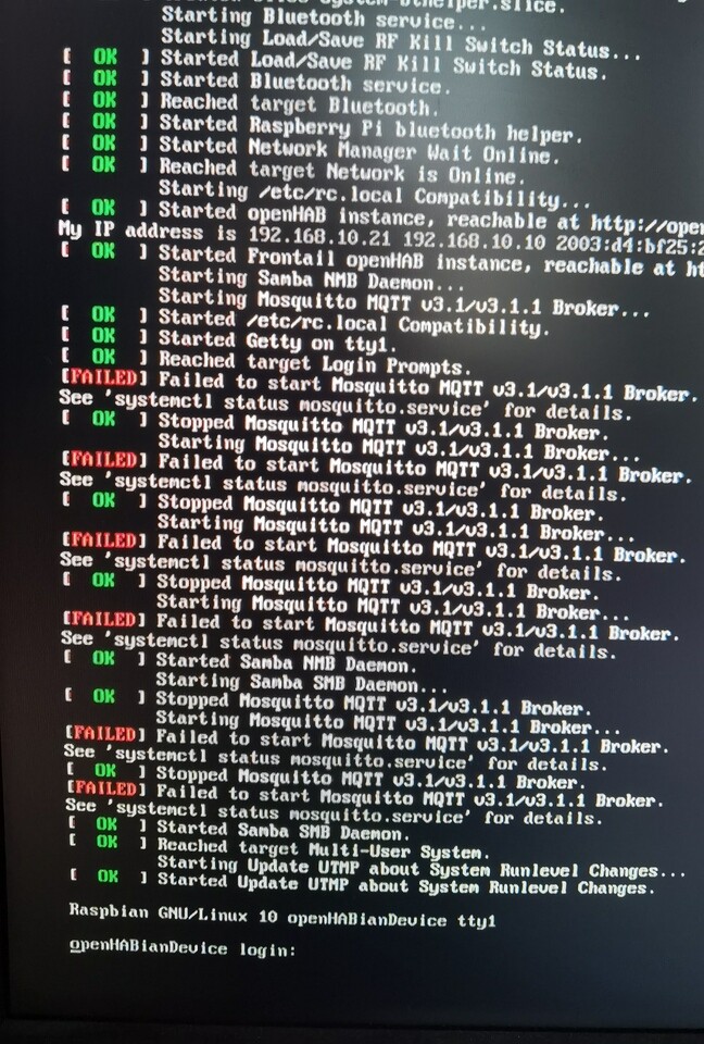

Now, the problem is back: After changing the Network to wlan and do a reboot, the MQTT isn´t running anylonger :frowning:

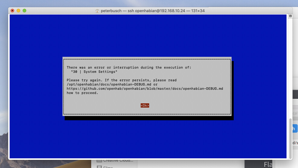

I´m using openhabian, but when I try to use ZRAM via config, it shows the error

If you want to use ZRAM then follow those instructions on your screen to read the DEBUG guide, which will give you more instructions!
The MQTT Broker isn´t working - the bridge thing shows communication error in red and when I try to connect via MQTT.fx it shows "unable to connect to server.
The DEBUG guide didn´t help me so much :frowning:

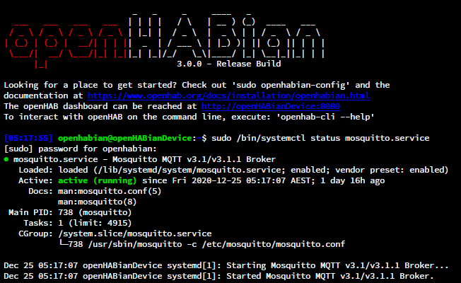

What do you get when you run sudo /bin/systemctl status mosquitto.service
Also can you post the mosquitto.log file sudo cat /var/log/mosquitto/mosquitto.log
Rpi 3b+ Msata SSD openHAB 2 latest main system for now but moving everything to a new home. Rpi 4 8 gig ram running 64bit os openHAB 3 on SD card
MQTT is your friend and the centre of my control system for heaps of things.
**[13:07:27]** **openhabian@openHABianDevice**:**~**$ sudo /bin/systemctl status mosquitto.service

Run
sudo systemctl daemon-reload
sudo /bin/systemctl restart mosquitto.service

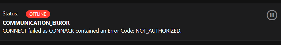

just discovered that still the binding shows a communication error but I proved with mqtt.fx that the broker is running.

Did you setup a password?
yes when I installed mosquitto with the config tool
Can you post your broker code
UID: mqtt:broker:RPI4
label: MQTT Broker RPI4
thingTypeUID: mqtt:broker
configuration:
  lwtQos: 0
  publickeypin: false
  keepAlive: 60
  clientid: bbea88c4-bcd2-4eb3-bc01-49d14720018b
  secure: false
  certificatepin: false
  password: pleasework
  qos: 0
  reconnectTime: 60000
  host: 192.168.1.248
  lwtRetain: true
  username: openhabian
  enableDiscovery: true
Brilliant!
so this was my config so far:
UID: mqtt:broker:openHAB
label: MQTT Broker
configuration:
  lwtQos: 0
  publickeypin: true
  keepAlive: 60
  clientid: 3b875904-088a-49da-8300-72ccd1447766
  qos: 0
  host: localhost
  secure: false
  certificatepin: true
  lwtRetain: true
with adding username and password it connects now to the broker again
label: MQTT Broker
configuration:
  lwtQos: 0
  publickeypin: true
  keepAlive: 60
  clientid: 4b8ce49d-81fe-410a-bd13-73973849eb25
  secure: false
  password: openhabian
  qos: 0
  host: localhost
  lwtRetain: true
