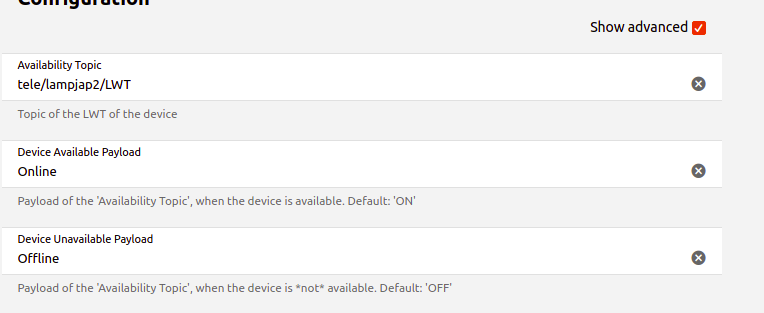

Below is my LWT set up for the thing.
Is there a way to force load the LWT? Like I said if I just save the thing then it goes offline (which is what it should be).
I am at a loss as why it doesn’t pick up the LWT.

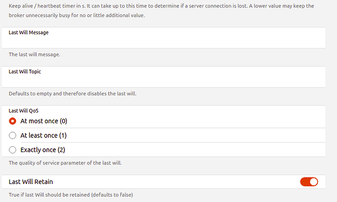

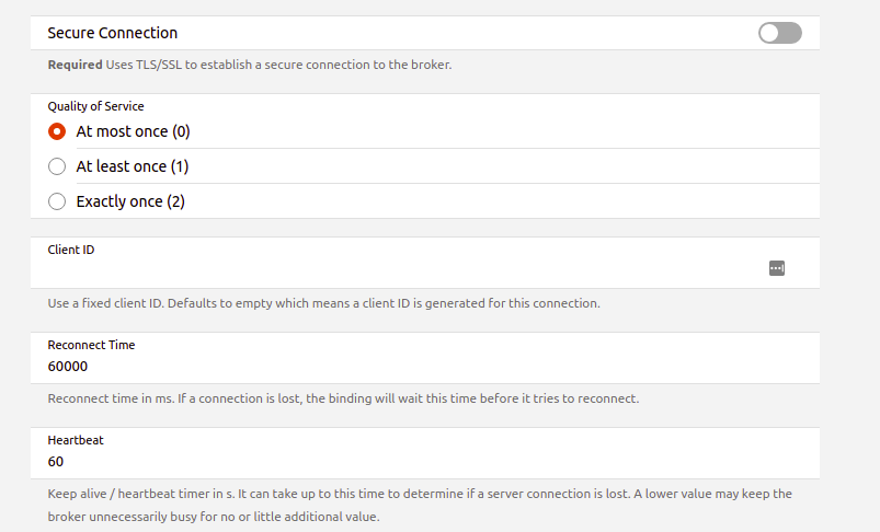

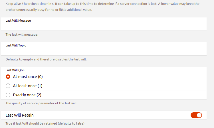

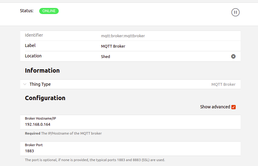

I just looked on the openhab 3 settings for the MQTT and there are no settings there.

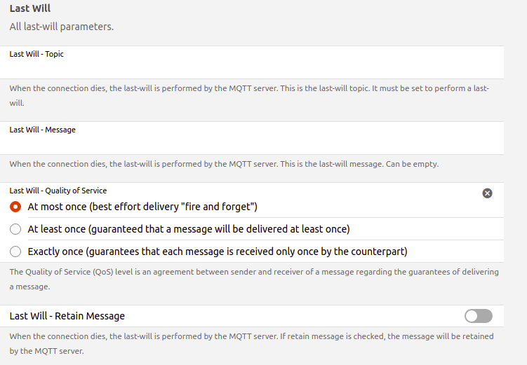

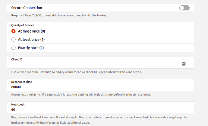

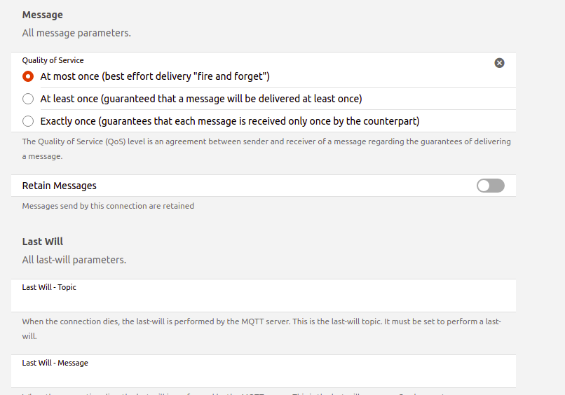

This are the settings for the MQTT server I am using.
Everything looks OK to me, but I am no expert. :slight_smile:
