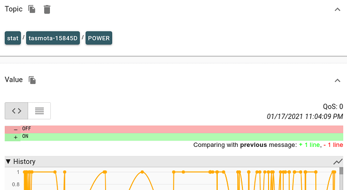

MQTT Explorer screenshot of stat:

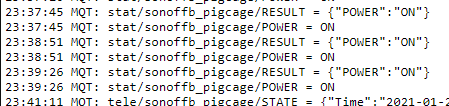

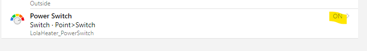

I am also experiencing this exact same issue… will turn on, the item text represents the correct status:
The item switch defaults to off:
Sending the on command works:
but the off produces nothing, not in logs on openhab or in console on switch.
