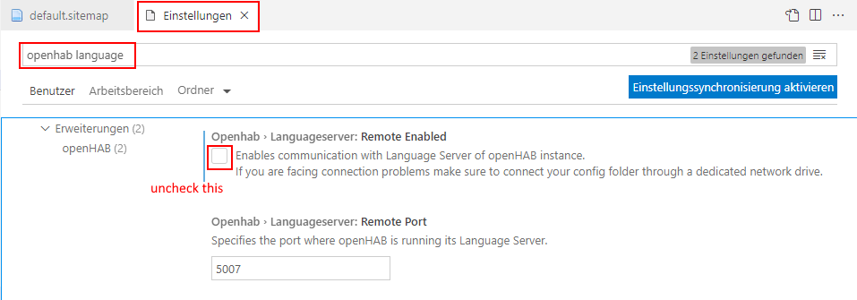

Optimizing the JAVA_OPTS didn’t do anything for me. Instead, however, I found the dependency on VisualStudio code and the extension to be the cause of the problem.
As Andrew said, one should disable the language server in the settings of the openhab plugin for VScode.
