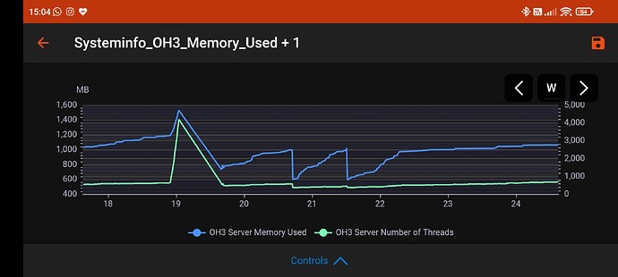

Trying to find out what causes my OOMs by disabling bindings…
Above graph is from the last 7 days. The “spike” was a shutdown where things were totally out of control. The last four days seems quite fine though, after I disabled a specific binding.
I won’t draw any conclusions yet though.

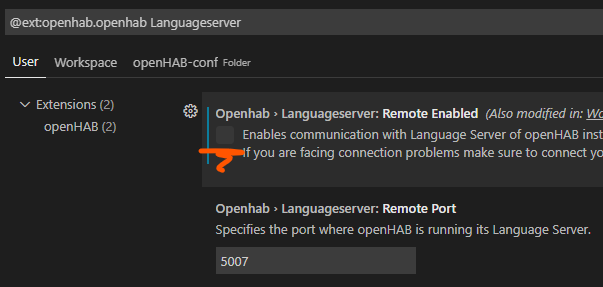

I only disabled LSP in openHAB extension in VSCode, I didn’t disable or uninstall anything in openHAB. To disable LSP in VSCode go to Extensions, openHAB, Manage and do a search for Languageserver option. Uncheck the option Languageserver: Remote Enabled.
Check User and Workspace settings.

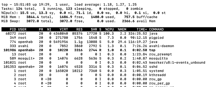

Every time the system crashes after a certain amount of time. I am now monitoring my heap.
I have seen that java uses 100% cpu as root. Is that normal?

@jelmer1 Can you check what process this is that is running java as root? In my install (openhabian), openhab java is running as the openhab user, not root.
Try ps -ef | grep java
