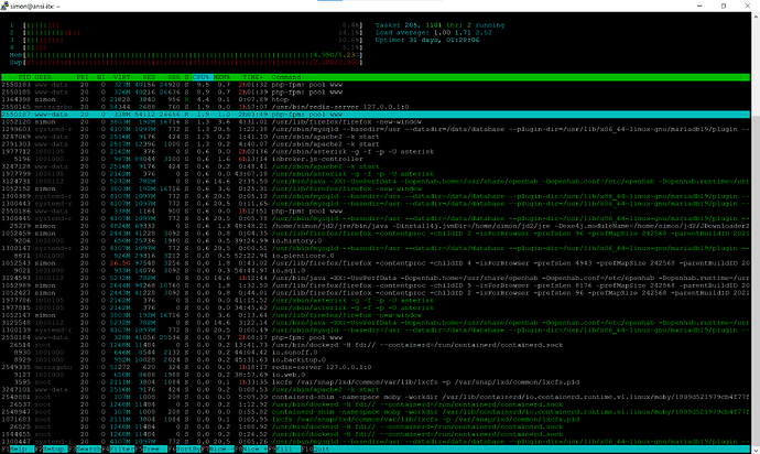

Here it my memory usage:
Is there any way to log the memory usage for some longer time? I try to find some correlation with other events.
