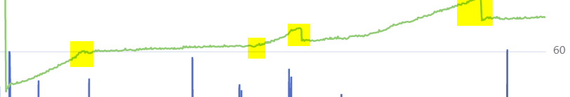

I had another one. After restart, I noticed a usage increase in memory, so I disbled all rules (first yellow box left) - leading to a NEARLY continous line but slowly increasing (up to second box left).
At that moment I enabled my run-often rules again and this led to a parallely increase of the usage up to approx. 65% (third box). Without any intervention, the usage then sunk and slowly increased again.
Last box is current behaviour, it reaches a “top point” and then sinks again.
I suspect rules and/or the management of the rules / rules engine to be the cause.
Or maybe its the item update handler - because my rules change a few items every run.

Nice picture :smiley:
I’ll interpret it as meaning rules do use memory, but it gets periodically garbage collected (your downward step). All seems to be as it should be.
Underlying that, something else is slowly grabbing memory, the gentle slope, which is never recovered.
Look at the bit in the middle - turning on rules increases slope upwards, but then that is mostly recovered at the step down. The difference between step and start looks to be a continuation of the gentle line.
