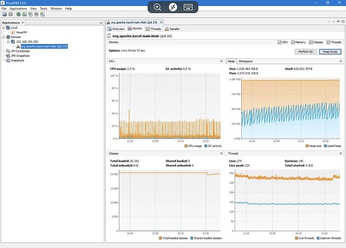

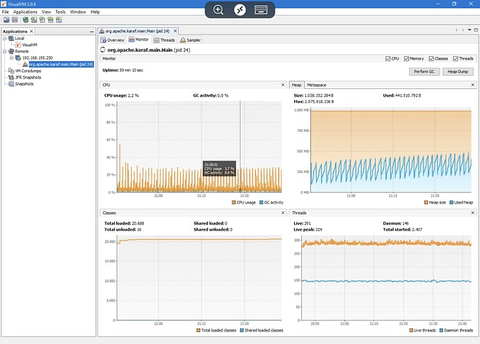

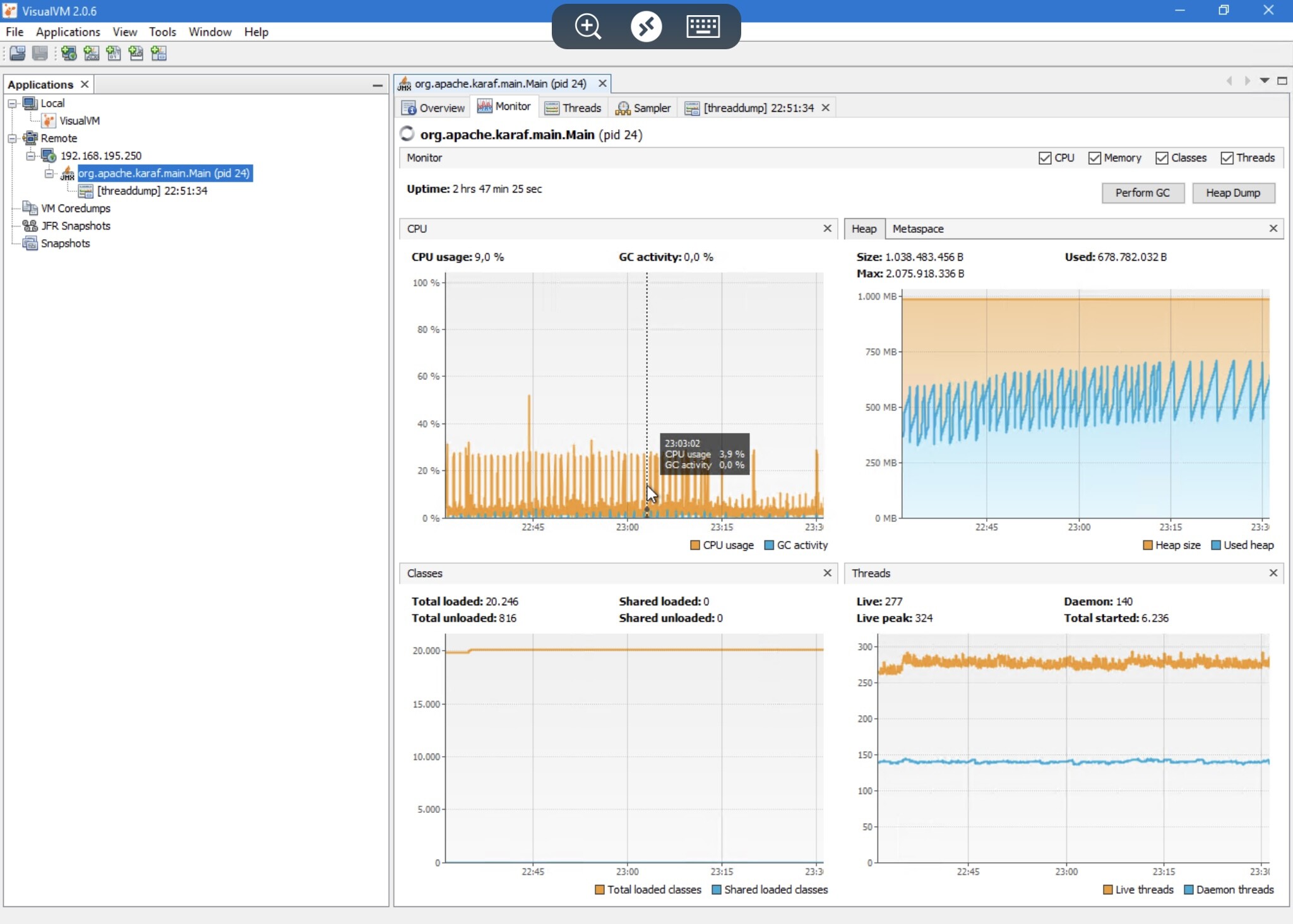

I set up the rules back in ui only and setup visualvm so i will report back.
1 hour uptime
2 hour uptime
HeapDump as 7z after 2h runtime

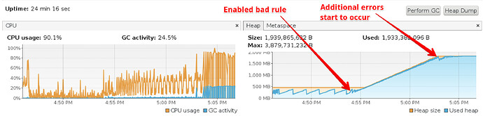

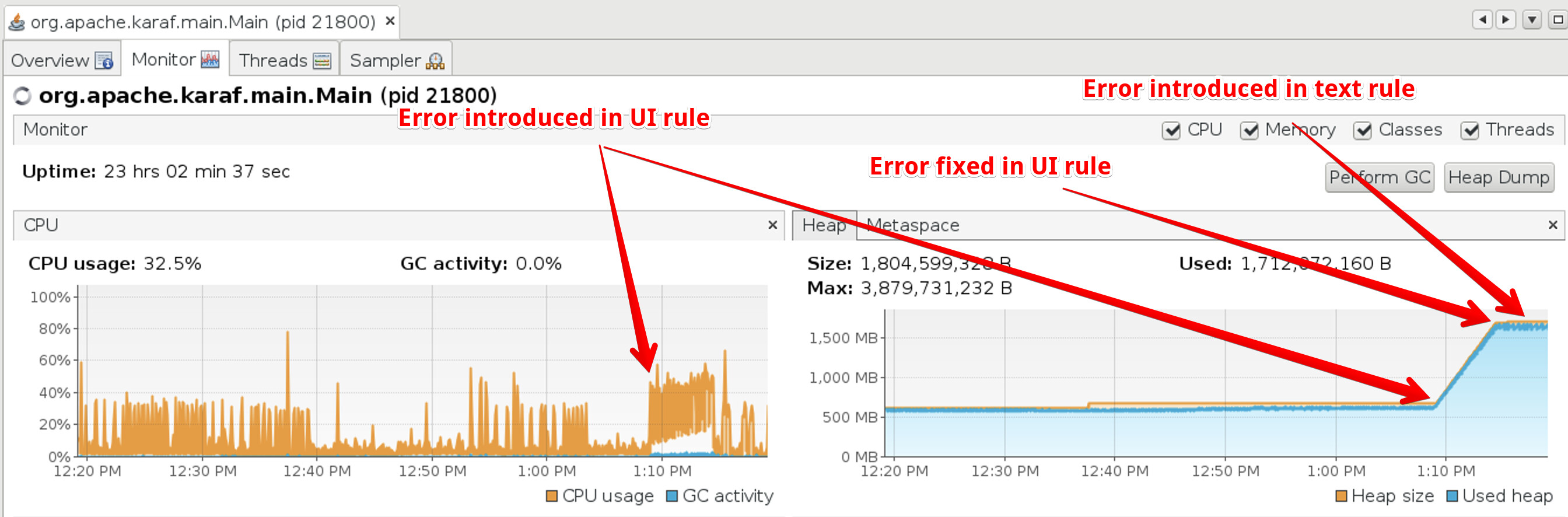

I had some time to play around with this today. I found something. It may not be the issue you all are having, but it’s definitely a problem. A really big problem.
I created a DSL rule that runs every second. It’s a very simple rule. I created that rule using the UI, and I also created the same rule as a text rule.
When I introduced an error into the rule created through the UI, memory consumption went bananas. To the tune of ~12 MB increase per rule iteration. When I fixed the error, memory stabilized. When I introduced the same error into the text rule, memory consumption remained stable.
For completeness, here’s the DSL text version of my rule. The rule created using the UI has the same body, and also runs every second.

Mark, thanks for checking out this issue. As you say, I think there may be more then one issue causing this problem but as many folks are experiencing it, I’m concerned we may have a real problem on our hands.
So from this, I’m guessing that when the error is run, the system doesn’t ignore the rule and attempts to run it? I’m not super informed about OH3 but from texted based DSL rules experience, I would expect the rule not to load and complain with an error. Was the error purposefully introduced into the rule something that an automatic syntax check should have easily caught?
Correct. It tries to run the rule every second.
The error was introduced intentionally. You can see the rule above, as I added it to my post.
