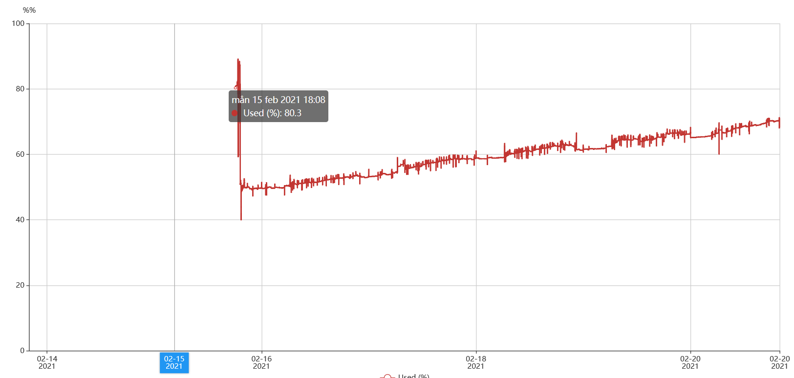

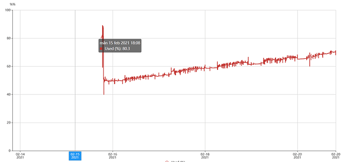

Looks like there’s work ongoing for most of these problems. Is there any more info needed?
My memory usage for the last week looks like this:
(I started measuring this monday and short thereafter restarted OH)
I’m planning to do a OH restart again soon too get more free RAM again. Anything I could check before doing that to provide more information about what’s leaking? I’m on 3.0.1.

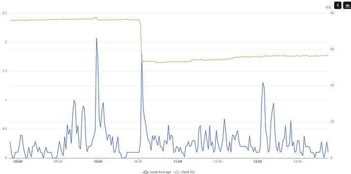

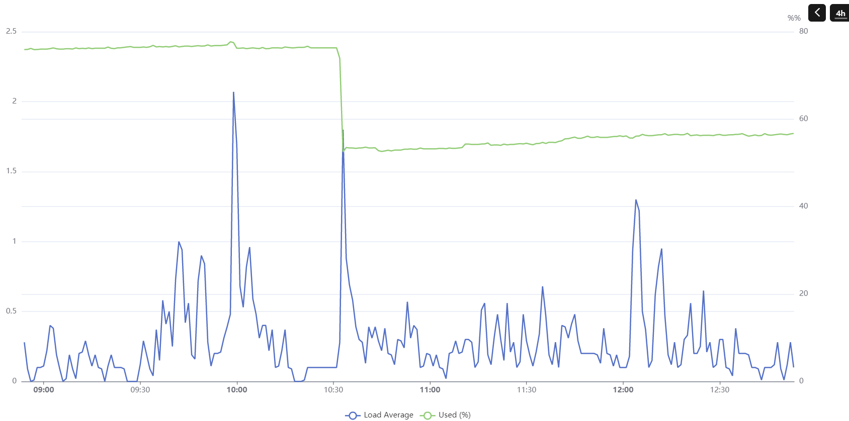

I’ve deployed the Snapshot S2217 into my production today 10:33am and memory still looks good to me, only a slightly increasing graph:
Thank you all very much for this
