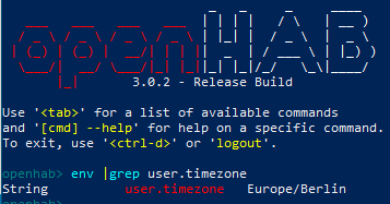

Login to the karaf console and execute
env |grep user.timezone
which timezone is shown there ?
grafik

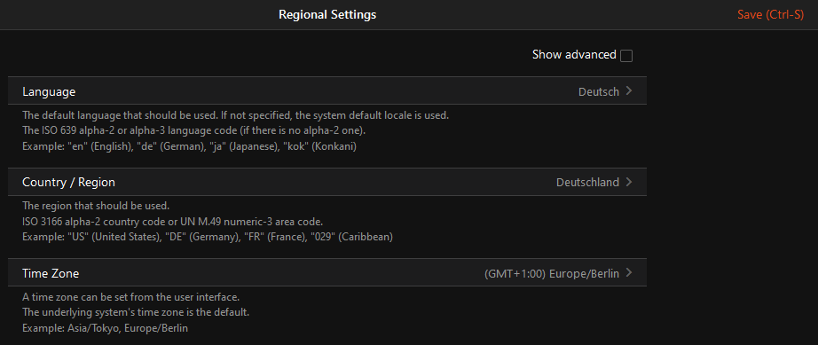

Everything is set correctly, I just checked it again.
These are the settings for the time zone in OH. I have already set another one for testing, but the result remains the same. OH only takes UTC time.

Do you also have the latitude and longitude set as well?
When openhab starts does the /var/log/openhab/openhab.log look similar to below?
2021-06-06 11:31:55.896 [INFO ] [.core.internal.i18n.I18nProviderImpl] - Time zone set to ‘Australia/Sydney’.
2021-06-06 11:31:55.951 [INFO ] [.core.internal.i18n.I18nProviderImpl] - Location set to ‘-36.553225183712215,152.3733062744141’.
2021-06-06 11:31:55.952 [INFO ] [.core.internal.i18n.I18nProviderImpl] - Locale set to ‘en_AU’.

Everything in the log is correct and the time is right.
The location is also right, but I will certainly not post it on the Internet. :wink:
