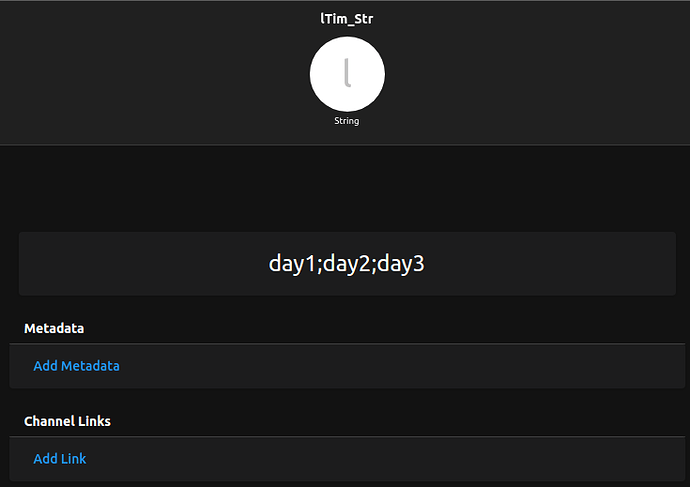

But it seems like i’m still having problems.
Now i have changed the value of lTim_Str to “day1;day2;day3”
→ So i should generate 3 list-items because of the three strings inbetween the semicolons, but it generates only one
Here how it looks right now:
