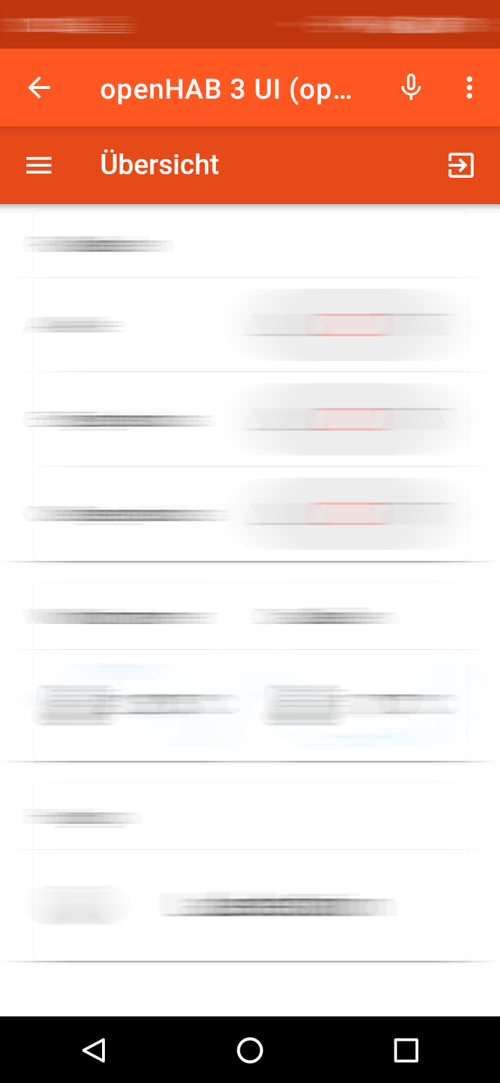

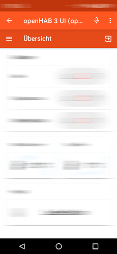

I tried the beta version of the Android app, but I don’t like the two navigation bars.
